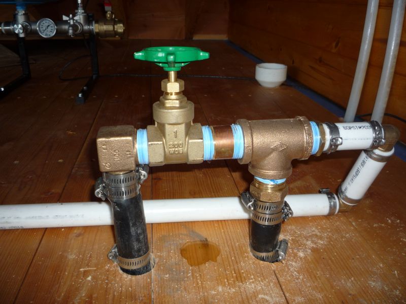

I was planning on winterizing my new small cabin (16 x 24, shed-style roof, with 16 foot high ceiling at the front wall, 8 foot high ceiling at the back wall, open cathedral-style ceiling, except for half-loft). However, I just found out that I can't blow out the pipes! What happened was, the guy who put in my septic tank also put in the water line and electric line from the well head to the cabin. Correction: water lines, plural. He was originally going to put in one line, but then suggested that, since I was putting in a frost-free water spigot by the well, that I should do two water lines. He said that way, if anything should happen to the frost-free, I'd still have water to the inside of the cabin. Okaaaay . . . It made sense to me, having no plumbing experience, so I had him do the two water lines. A few days later, the pump guy comes to set the pump in the well and he disagrees that the two water lines were the way to go. But the deed was already done, so he said he could put in a "T" connector, and everything would be okay. But then when it was all done, I asked him a bunch of questions about the pump and the pressure tank, etc. And then I asked, "So how do we blow out the pipes to winterize the cabin?" And he said, "Well, you CAN'T blow out the pipes because of the two water lines and the "T" connector." Imagine my chagrin!
So I guess first question is whether the pump guy is correct. Is it impossible to blow out pipes when there are two water lines and a "T" connector???
Second question, if this is true, will my 3 Cadet wall heaters I had installed be able to keep a cabin this size above 40 degrees in the winter to keep the pipes from freezing? And is it safe to have them on when we are away from the cabin for up to three weeks between visits? They are hard-wired in and were installed by a professional electrician. They don't have an "off" switch and at their lowest setting, they turn themselves on when the temperature dips below 40 degrees. I'm just wondering if it gets below zero (rare, but it does happen at least a few days every winter), will these 3 Cadets run and run and still not be able to maintain 40 degrees? They do have an overheat-turnoff feature.

I am sure there is a way to blow it out. I winterize huge irrigation systems with miles of pipe and 100s of tees without issue. Could you post a diagram of the piping?

If I read the description correctly, you CAN install a Valve on the the water lines right after the T-Split and then your air-valve fitting.
Assuming you have a Pump that feeds a pressure tank which then feeds the cabin.
PressureTank->-{_Valve->-Air-Fitting___>to cabin.
Hopefully you plumbed using PEX which makes adding in bits a whole lot easier and simpler even if the fitting are slightly more costly. If plumbed with Copper then it's more effort but still not that bad of a job.
W/O Pressure tank would be similar.

Irrigationguy: Thanks for the reassurance! I hope my pump guy is wrong. I will attempt to upload a picture of the "T" connector . . . Okay, I think that did it. One of the black hoses is for the frost-free spigot out at the well head. The other black hose is for water for inside the cabin. The "T" connector, the water pressure tank, and the pump drive are all inside the cabin, in the loft, directly above the cabin bathroom. The electric tankless water heater will be installed there, too, in a couple of weeks.

I think I understand what is going on now. How deep were the pipes buried and what is your frost depth?

I think the reason your well guy said it can’t be blown out is because with your hydrant fed from inside the house as apposed to teeing off the lateral in the yard the water between the well and house is sort of trapped. If the hydrant came direct off the lateral you could blow air into the system via the house and open the hydrant to clear the well lateral. As I see it you have a few options:
1-dig up lateral near the well head and attach hydrant direct to give an escape route for the water.
2-take apart the tee fitting inside and make it a cross with a removable plug where an air line can be inserted down into the well lateral to clear any water in the portion of the pipe that isn’t buried below the frost line (this will be a little messy)
3-you can pop the drop pipe off the pitiless adapter briefly to let it gravity drain back into the well.
4- pull pitless adapter and install sninfter valve just below it.
I would go with number 1 or 4

Thanks, Irrigation Guy! This must be along the lines of what he meant when he said he would have to pull the pump. Whenever he explained anything related to the pump, the technical terms and procedures went right over my head, making it hard to understand what he was trying to get across to me.
I'm meeting him at the cabin tomorrow. He has to fix a tiny leak that occurred under the "T" connector (shown in my picture), when we first got the water running out to the hydrant. I have printed your responses and will run them by him. Thank you very much!
