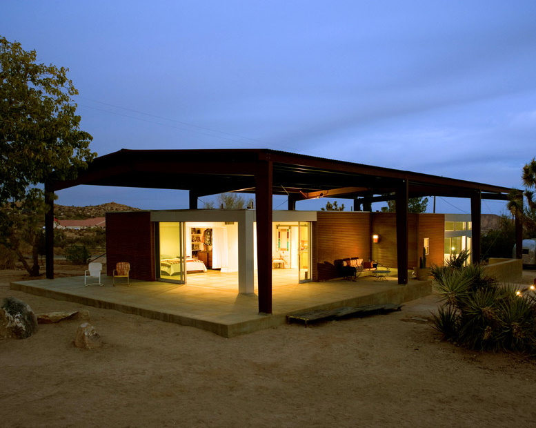

The best way to cool a cabin is to not let it get hot in the first place. The greatest contribution to heat for most buildings is solar gain through the roof, windows, and walls. My cabin roof overhangs enough in the summer to prevent any sunlight from entering the cabin, and the roof space itself is extremely ventilated with the insulation being below the attic space. Whenever I open up my cabin for summer visits it's usually cooler inside than out.
For locations such as yours you could build a separate roof structure to shade the entire cabin. The pic below shows a good example of it. I know it's extreme, but it would shade all surfaces of a cabin and provide for a lot of shaded outdoor space.
