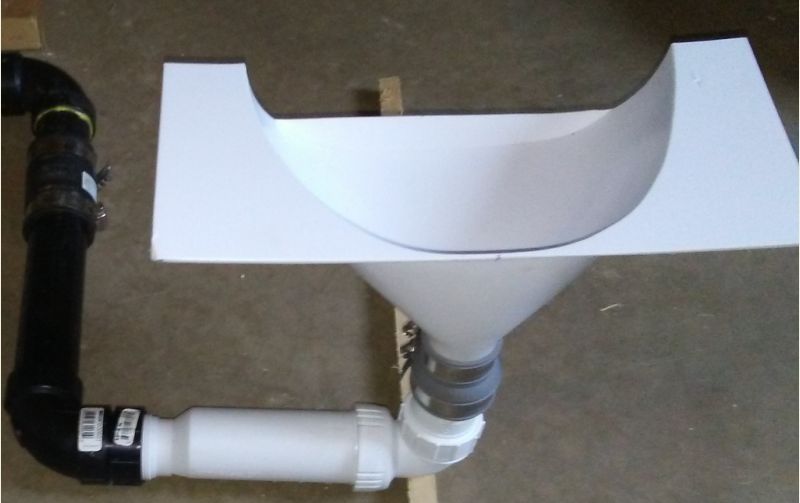

I settled on a Sawdust Composting Toilet system, with a http://www.we-pee.com/ Urine diverter which allowed me to tie that into my Grey Water system, which takes the sinks, shower, Urinal & Toilet Diversion.

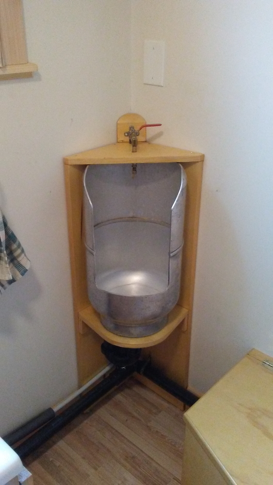

The Urinal (30# aluminium Propane Tank modified).

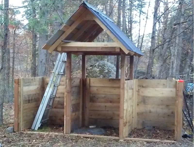

The composting station - each segment = 4'x4'. Posts are PT, planks are all Eastern White Cedar.
WePee diverter setup with the HepVo waterless P-Trap which saves the issues of winter freezing potentials and better/tighter clearance space.
HepVo Link: https://hepvo.com/hepvo-waterless-valve/

The Urinal (30# LPG tank modded)
The composting Station
WePee-HepVo-Setup
WePee-HepVo-Setup

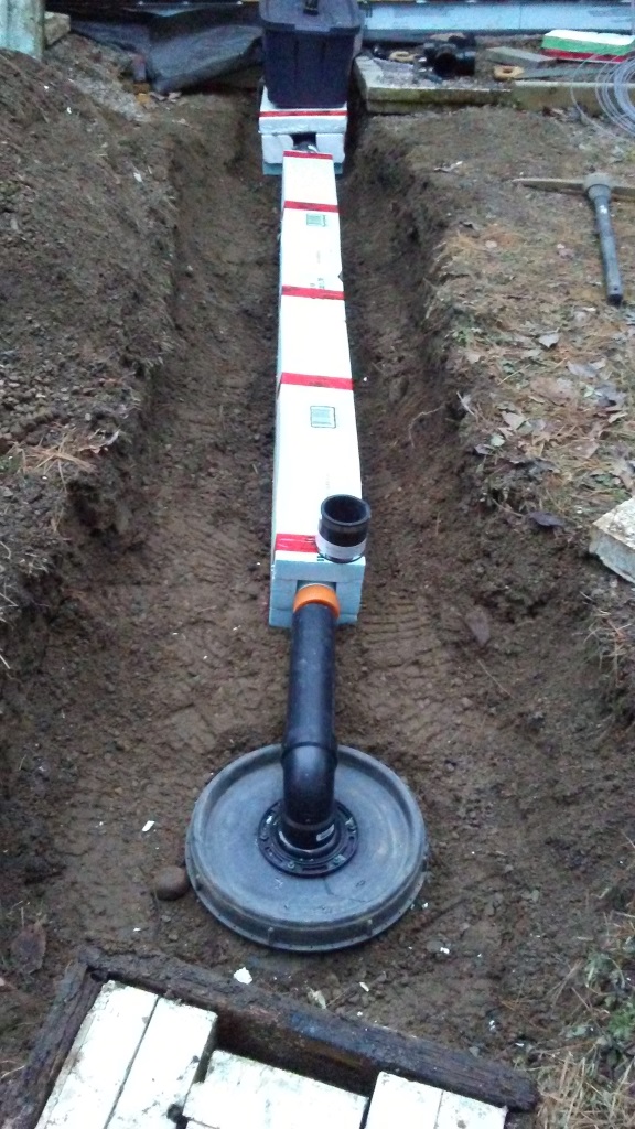

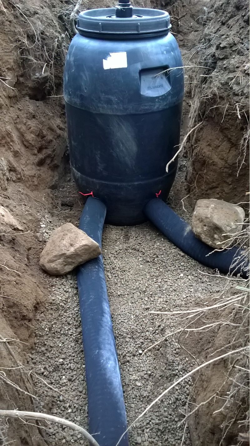

None of my pipes are in-wall or in-floor, all surface mounted inside but not visible in general.

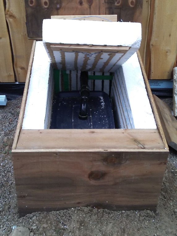

Drainpipes from sinks, tub/shower, urinal & WePee diverter are 1-1/2" ABS. This goes through the wall into the insulated "filter catch tank" outside. That in-turn goes with 3" approximately 12' to a 50 Gallon Dry Well (50gal. olive barrel). There are two 50' long runs of Corrugated O-Pipe with filter. They are 10' deep and decreasing elevation from the tank (I have a slope that works to this benefit), laid on a 1' deep bed of drainage gravel (with commercial GeoTextile under the gravel & over it) and 1' of gravel over the pipe before the GeoTex.
The soil here is Sandy Loam averaging 10-15 feet deep, so it drains really well. It is actually a Septic System dream soil.....
I have tested the water absorption test by literally hard dumping 100 gallons of water in and watching it all vanish super quick down the system. I have tried to "flood" the dry well in an attempt to see if it backs up a bit, I could only manage to get it 3" above the 3" pipe holes at the bottom. I had two hoses & was pouring 20L buckets in at the same time, no problem.

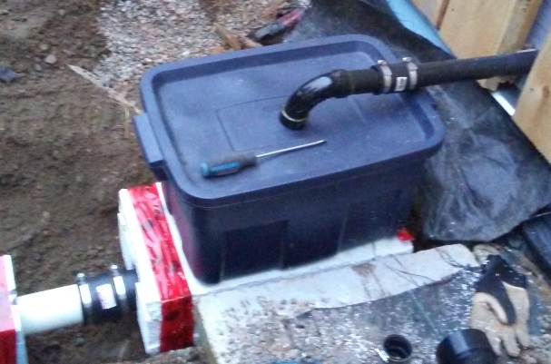

I did put a Computer Fan (12V/80cfm) in the "seat" you can see the 3" pipe stack back right. I've only used it when making extra stinky, but after it's covered in sawdust no more stinky. Use is quite mimimal.
RULE 1 Of Sawdust Toilet DO NOT USE CEDAR ! Pine and other softwoods are great because the decompose fast, NOT so with cedar. The finer the sawdust the quicker it clumps, so use not too fine or too coarse.
See attached photo's for more details
External Filter Box
External Filter Box
exposed view of filter box
Filter box to DryWell tank
DryWell tank with drain pipes

I suppose I should have mentioned it. In winter I still take it out to the composter, knock the snow cover off, dump the bucket in, add staw cover & walk away from it. So it freezes up pretty good.
Come spring thaw, the frozen stuff actually breaks up while thawing and the entire pile shrinks. During summer, everytime I make a bucket deposit on the pile, I add one shovel of soil on top before putting the straw cover on it. There is never a smell, no critters go near it or bother it, not even flies which you would expect, most certainly in a forest like I am, which was a surprise bonus I hadn't expected. One thing that does get into it are worms and similar which are the right critters to have to break it down quickly.
As the picture I posted above, the centre section is for the straw (NOT Hay) and some other stuff. The two sides get the rain-snow fall off the centre roof which helps it work quicker. That could be redirected to a Rainwater holding tank for washing the buckets out but I have running water down there.

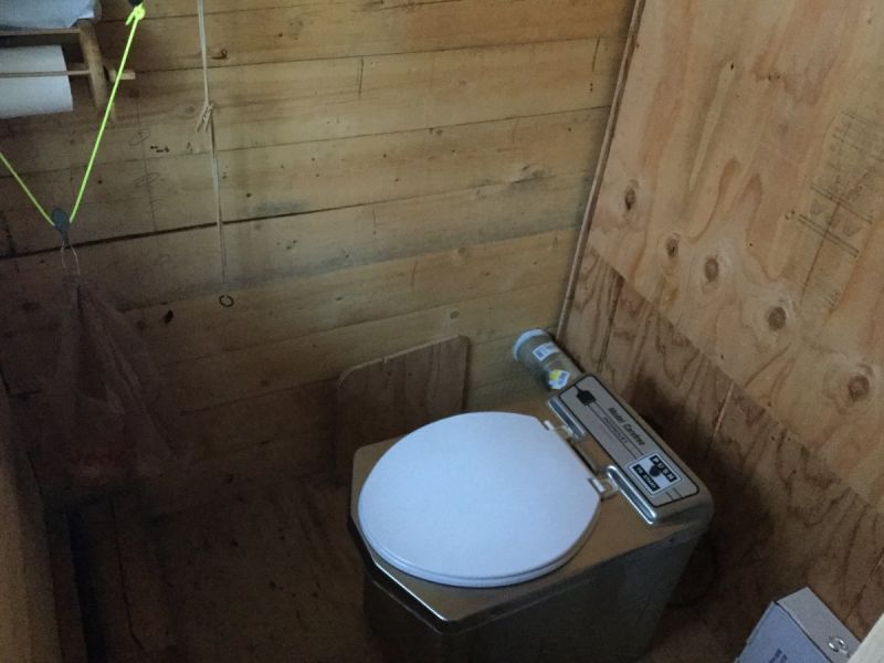

Hi there, I am set on an incinerating toilet and for those of you who have had them for a while, I'd love some feedback on any advice for venting, installing, trouble shooting, maintenance. Thank you!
# Posted: 26 Jan 2023 08:50am
Yes we actually have one and it works very well. And there is no odors, very easy to wipe down stainless. They are made for boats. So safe. Your not going to burn anything. And they are very tough made in America and have great customer service. Incinolet brand. Set it down were you want it. Uses 4" black plastic abs pipe. Rubber collar hooks it to pipe. Put the pipe out the wall up to 10' away. Put a vent cover over the pipe end. Plug it in. Our to half hour. Basically drill a 4" hole in the wall is the toughest part.
