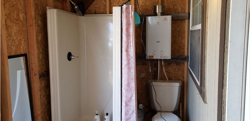

I'm gonna put it just above the toilet so it'll have maybe 3 feet above it and be on the outside of the 2x4s so it'll have space all around. I'll pick up a co monitor but its sounding like the ventilation around it should be plenty. It's in the middle of nowhere so leaving the door open if the weather is nice is a non issue. Internet_20210709_06.jpeg

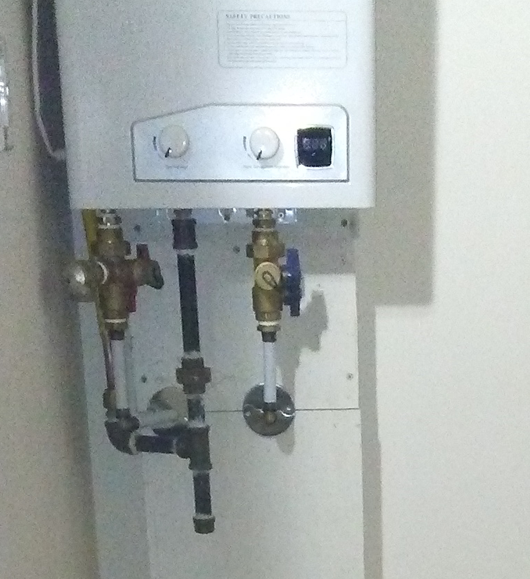

I use an FVI-12 for Hot Water. (2015 model) 3/4" pex from well to Hot Water Heater location. There it splits to two 1/2" pex lines, 1 to HW and 1 for the cold. Did it this way so that regardless what is running the pressure is consistent to hot/cold lines.
The pressure required to trigger the heater is a PITA, mine is anyway. The reason is that it requires a Minimum of 22psi (50-60 PSI recommended) and had to flow a Minimum of 0.98gpm. Water Saver faucets just don't flow enough, even fully open.
The "Fine Print" notice also states: If using Mixing Valves on the outlet, chose one which prevents cold water pressure from overcoming not water line pressure. ( I failed to see that, got the wrong type and Grumble grumble...)
I took it one step further for maintenance purposes and to meet requirements I used a proper On-Demand Heater Kit from WATTS like this:
See attached photo of the setup. Apparently the Cut In Pressure point has been changed since my model was made, so make sure what the specs are for your particular model, because it IS a pita to figure it out after the fact.
Hope it helps, Steve

So yours is 1/2 pex actually into the bottom side of the water heater right? Looks like it in the picture. That should be a similar setup to how mine is. I have 1" to the bathroom then has 1/2 breakoffs to the fixtures. The line going into the bottom of my water heater would be easier to run 1/2 since its stubbed out already but if I had to I could crawl under the cabin and tee off the 1 inch with a 3/4 line if it will make the heater run better.

Quoting: nirvanamike06 So yours is 1/2 pex actually into the bottom side of the water heater right? Just below the heater (behind the stand panel) has 3/4" pex, which has 1 T fitting that goes to 1/2" Pex then to Input Valve. Hot output is 1/2" only. The END of the 3/4" pex below steps down to 1/2" for could out supply.
Sort of like this: ===3/4====T===}1/2"-Cold Out. ....................|| ....................1/2" to HW Heater. ignore the periods, just for spacing.

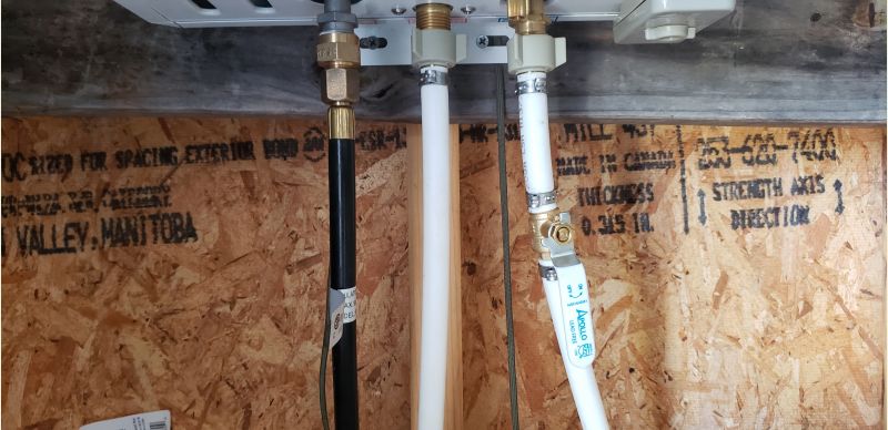

I'm also only planning on putting a shutoff on the cold side. Don't figure i need one on the hot. 20210729_162114.jpg

I used sharkbite fittings on mine to connect the pex to the water heater. They are easy to remove (just a wrench) leaving the fitting connected to the pex.
I’ve only removed them once due to a leak issue but it’s a simple job

I got the setup all put in, surprisingly fast to using the pex, fired it up! Nothing..... clicking, I can see the spark but no ignite. Try the bottle on the grill, pressure when I break the seals. Call tech support. Says closed. Mad as heck thinking its within hours until I realize its Saturday.... found a couple q&a writeups on their website and says to take apart the solenoid but when I look inside the unit I can already tell I'm gonna break something trying that. I start to notice I haven't smelled gas the whole time so I think man let me just break the pressure on the line into the unit one more time. Cracks pressure releases.... Poke a screwdriver inside the units tapered gas fitting and it won't go. Somehow a dagum piece of hard plastic like the shipping covers was inside the fitting! Looked at my fittings and there was no circle cut out of them so I got no dagum clue where that came from. Fired up like a charm after that.
Then the temperature problems. Also its heat of the day by now but I couldn't get it to turn down. The flow on the unit wants to be on the minimum setting. I turn it up a little bit and it kicks off. Then per advice from here I took the shower head off and drilled it out. It gave me just enough adjustment on the flow setting to get it perfect. I took a shower last night about 10pm and it was super easy to adjust and had alot more play in the temp range. It would be nice if I could bump up the flow on the unit though to cool it down or maybe I just needed a smaller model? I did find if I turned the sink on i could adjust the mixing valve wherever I wanted.

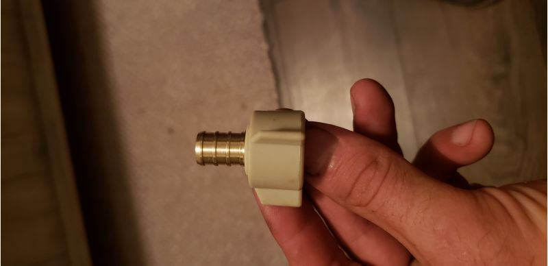

Also heres my fittings I used in case anybody ever ends up in the same situation as me and trying to figure out what works. These swivel and despite my worries they didn't leak a drop and I just hand tightened them. I made sure they went on square because I did notice on the hot water the openings don't line up as perfect as the cold water and it would angle the brass piece if you didn't hold it.
