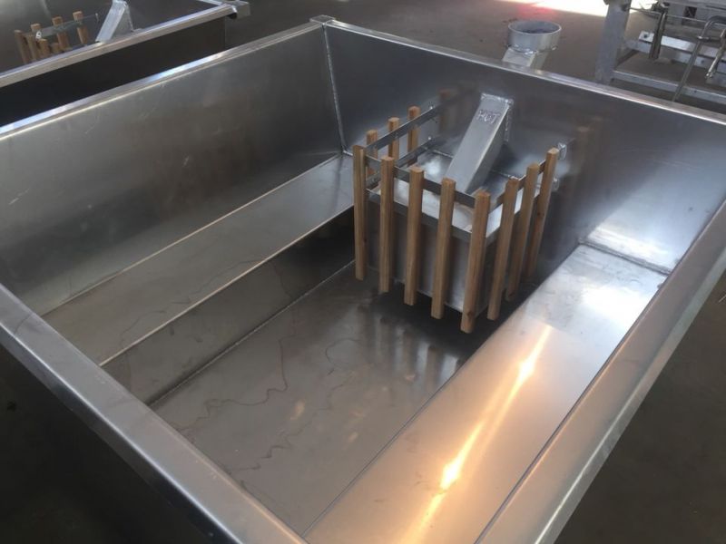

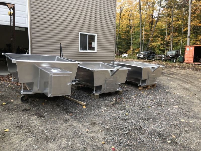

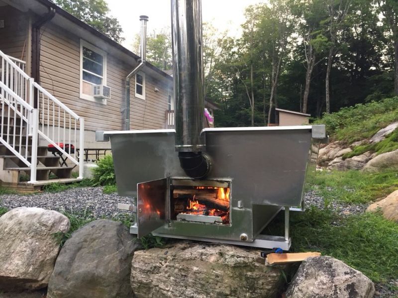

I saved these pics from a Kijiji ad a couple of years ago. There is a welder in the town next to my cabin that was making (EDIT) aluminum hot tubs. He was asking $3000 Canadian. I really wanted one but it wasn't on the priority list.

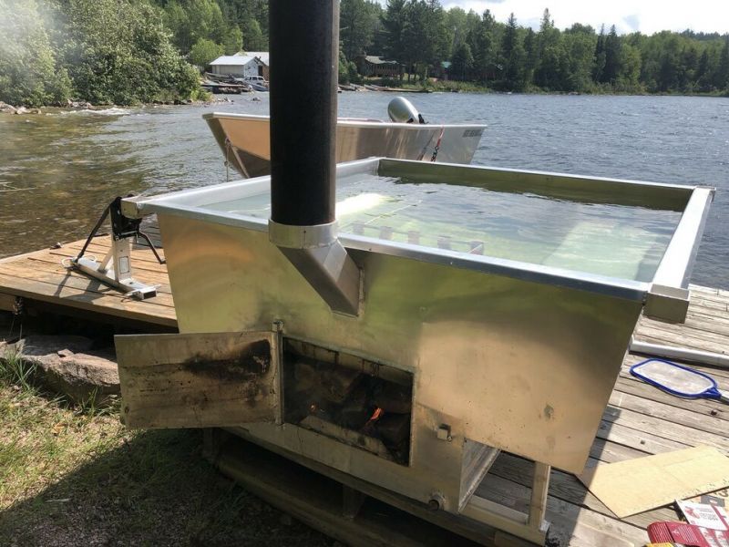

This is what we have. It is marine grade aluminum wrapped with cedar. It also has cedar benches installed inside. We have had it since 2007 with no complaints
https://alumitubs.com/
I can post some pictures if you are interested.
# Posted: 9 Sep 2021 01:09pm
Quoting: KelVarnsen
I saved these pics from a Kijiji ad a couple of years ago. There is a welder in the town next to my cabin that was making stainless steel hot tubs. He was asking $3000 Canadian. I really wanted one but it wasn't on the priority list.
That's pretty cool. I think you should move it up on your priority list.

Look at snorkel tubs for ideas https://snorkel.com/.
Cedar tubs with a submerged wood stove for heat. Been thinking about something similar myself but haven't found the time.

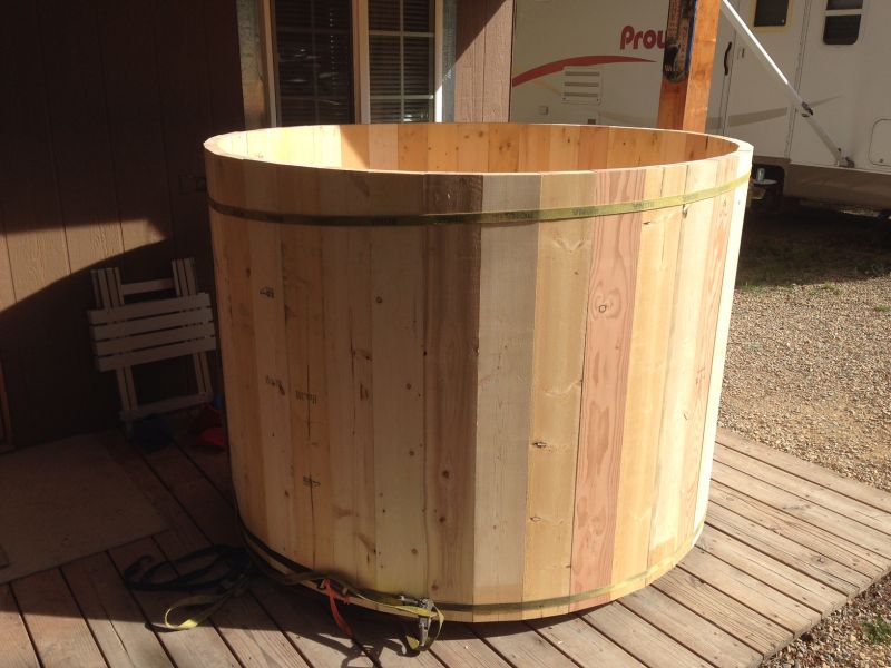

I have built 4 of them now. Pretty easy really. They were all made out of spf 2x6 cut into staves. Floor was either doweled or t&g. All had liners.
