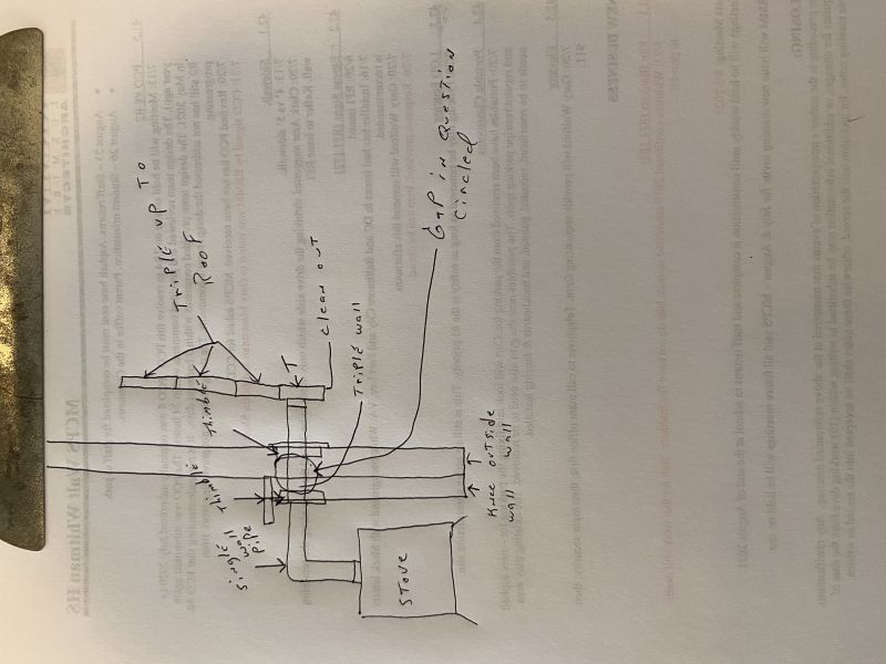

Srollins
# Posted: 11 Sep 2021 09:55am
Here is a sketch the circle in the middle is the gap I’m referring to , maybe this simplifies what I’m trying to explain?
Sketch
Sketch

Atlincabin
# Posted: 11 Sep 2021 11:16am
If it were me, I would at least put some additional metal in there to connect the two thimbles. Better yet would be to get your local fabricator to make a piece of triple-wall pipe long enough to do the job.
Srollins
# Posted: 11 Sep 2021 11:55am
Agree with the additional metal but check out the sketch again I have triple wall thru the whole thing from inside to outside
# Posted: 11 Sep 2021 04:02pm
If the tripple wall is exposed a bit on the interior that would be fine, stove paint is cheap. My cathedral ceiling box sticks down about 2in through the drywall and theres a square trim piece around that so it finished nicely.
I also wouldnt go through the wall with the chimney at any costs. Run through the roof and use a high temp silicone boot at the roof.
# Posted: 11 Sep 2021 07:44pm
Iirc the 3-wall pipe I was looking at last year (but ended up not doing a woodstove) had something like a 2" clearance from the outer pipe to any potential 'combustable'. The tin enclosures (firestops?) to provide such had that extra air gap and insulation could be packed right up tight to the 'box'.
Roll a tin tube (any tin-shop should be able to do it) with the air gap and run the 3-wall centered through it. It doesnt need to be made air-tight or anything.
Just dont take the number of inches I mentioned as correct, dbl check your requirements.
