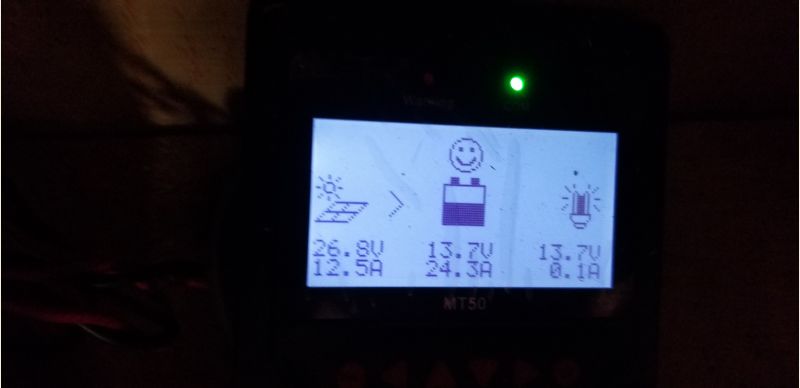

I have 12g UFB from my pannels to the CC right now. The wire is the UV rated stuff but is solid copper. I dont intent this setup to be in the same spot in 2yrs so didnt spend much on things like the rack and wireing. Mostly used what I I that was overkill. I have 460w of pannels.
