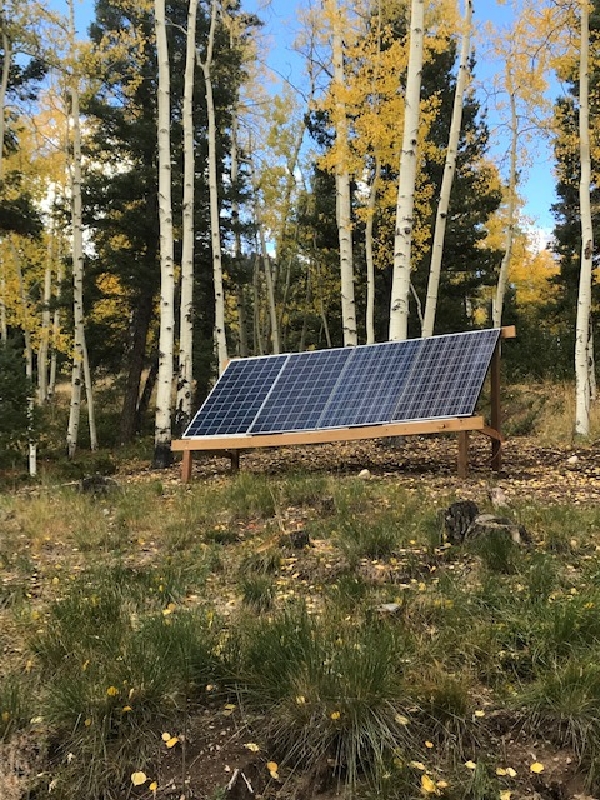

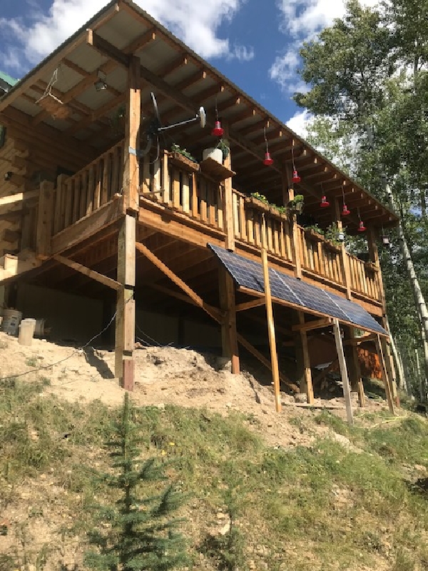

Our main solar array is mounted on the cabin roof, so when it snows we lose most of our charging ability. We have 750watts of panel mounted on the front of the deck where we can sweep the snow away...that certainly helps. I also have 1000w of solar on a new ground mount that charges the system dedicated to the shop. Enter a friend with a couple of spools of #8 AWG... "Use all you want," he said! So I ran from my shop to the combiner box on the cabin, added a breaker there and a 3 way switch in the shop. It's a pretty long run so I still get a good bit of line loss but full sun tests are showing ~800watts still getting to the cabin. I'll take it! Did have to put warning labels at the 3 way /combiner box to NOT RUN main array and shop array at the same time. Would be slightly over SCC voltage.

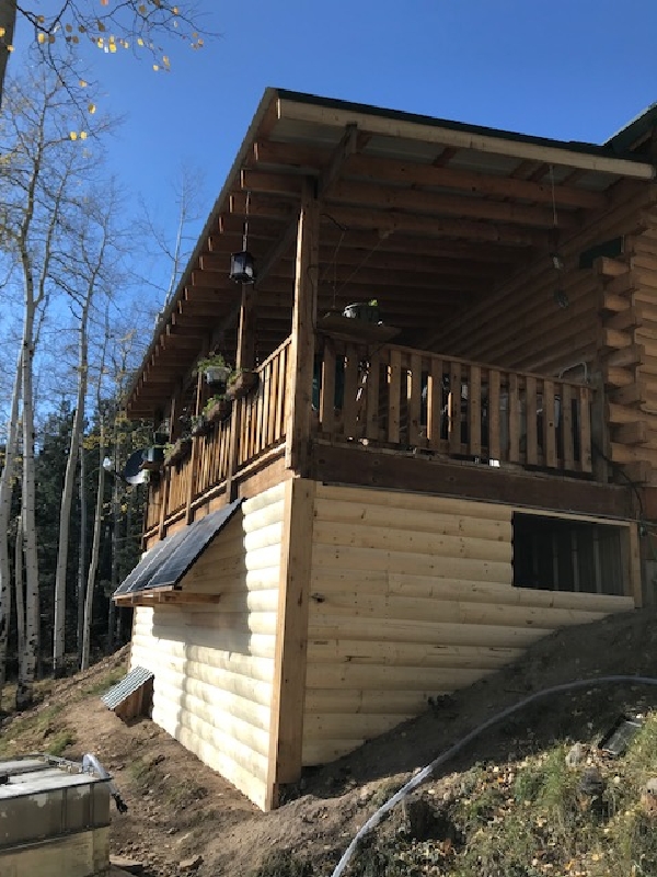

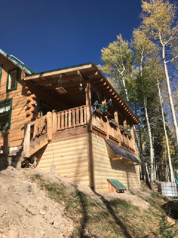

The other project was to frame in and log side the unsightly back deck framework. Also will help with fire mitigation. Still need to stain the log siding and mount the access door.

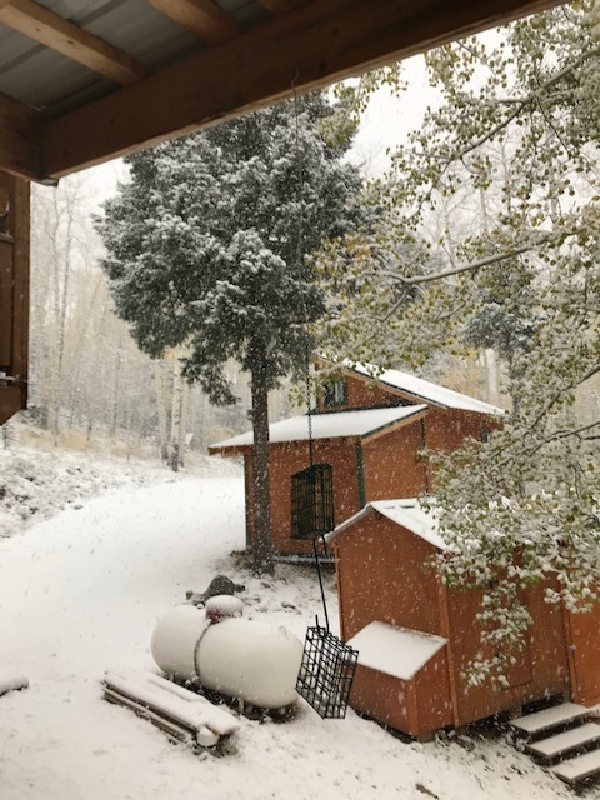

The pictures of the new log siding were taken yesterday.... the snowy one today! We are expected to get between 4" and 10" today... and we are already over 5"!

Another picture... east side and access door cut out.

I like your ground rack. Mine is very simple for 6 panels, each pair on its own 2 legs that I can move as needed/wanted. Then I do a ground screw with a cinch strap to secure. They are waayyy easy to broom off yet high enough that our ground snow never got close last winter.
What 'log siding did your use? Any tips, my wife is saying she would like me to do the whole 16x24 exterior.......after I get the new windows in.

The log siding is milled at a local Amish molding shop. It's like ship lap with a radius. The gable ends of our cabin are done with it as well and you really can't see where the D-logs end and the siding begins. Goes up fast with two people. The only tip I would have is vertical end boards to butt it up against. I think they do make fake log ends for the corners but my guess is that would be $$$. For figuring purposes, this direct from the mill was ~$3/sqft.

Plan - B in action! The snow stopped after dumping about 8", cleaned the panels off and now as the sun is starting to peek out from behind the clouds, I'm harvesting +700 watts.... while my main array is still covered! Yipee!

It could not have been easy to install that log siding on the deck framework with the steeply sloping ground. Nice job! Any hints on how you did that without sliding down the hill?
# Posted: 12 Oct 2021 10:52pm
Quoting: Curly
You noticed that! Our land is basically all hillside except where flat areas have been carved out. The view is great but working on the hillside is tough!
It wasn't easy! No hints... did slide... often! Both framing and siding were quite a task. My wife helped with the framing and after 3 days we were beat! My neighbor helped me do the siding.... he tumble down the hill once! Caught himself before injury. Took us two half days, the front was not too tough other than climbing up and down for 4 hours, we cut up top and brought the boards down. The ends... felt like you were going to fall the whole time, legs tense and on your knees for the lower boards. Glad it's done!

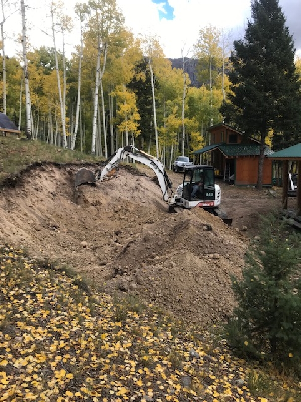

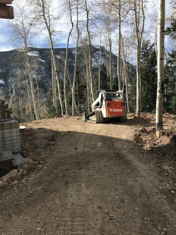

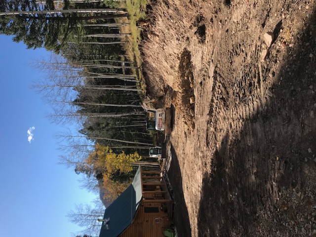

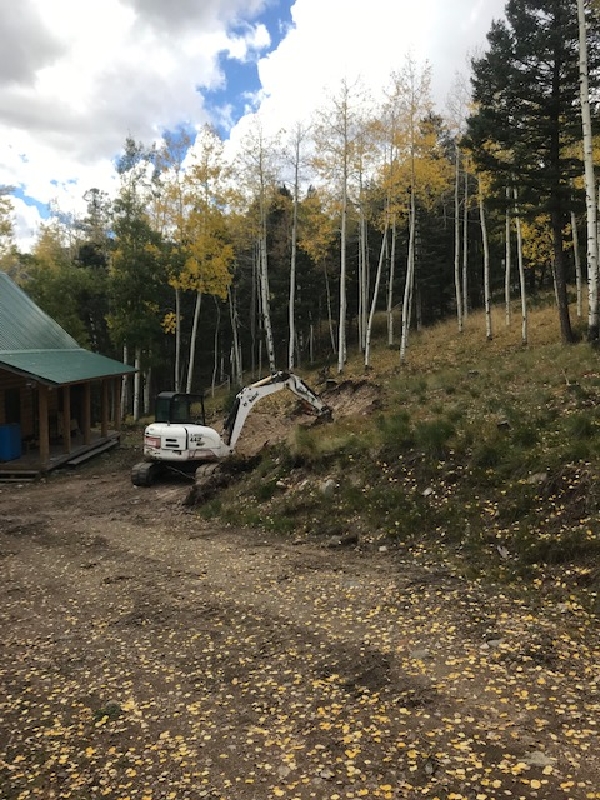

Getting another project done.... well we hope to get it done before winter otherwise we will be in the mud! We are on a hillside and there wasn't even room to turn the pickup around at the cabin. We had to turn around before the driveway and back in.... same for when hauling water each week. So hired a local earth mover to dig our hillside back about 15 feet then move the overburden around the side of the cabin to build a nice sized yard. We really didn't even have a decent flat spot to put a fire pit on or any kind of yard!
He will be hauling in gravel to cover the enlarged driveway/parking area and topsoil for the side yard. Mainly want the gravel before winter other spring thaw will be a mess!

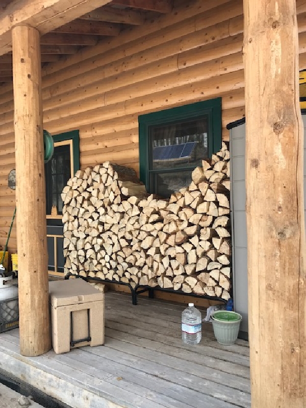

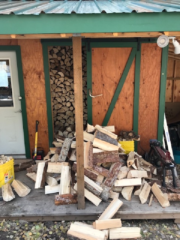

Also got in another half cord of good dry, dead standing spruce. The neighbor needed a little wood and I still had permit for a full cord. Got the woodshed filled back up from burning this fall and restacked the porch for winter.... we always clear the porch off in the spring for fire safety.
Here's some pictures
