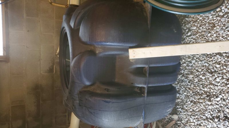

The rain water collecting system in my cabin is very straight forward: sloped asphalt shingles roof (yuck!) with gutters that bring the water to (2) 500 gals tanks above ground.
It is getting colder so I decided to empty one of the tanks, the tank which receives the first water out of the roof.
I have no idea how to clean inside the tank but I suspect it is a good idea to do so.
And since this is new grounds to me, I would like to hear other's perspective and advices.
The very first thing I would like to understand is whether I should disconnect the 4" PVC pipes from the tank then flip the tank on its side to clean it OR if I should be able to clean it in place.
How do you clean your above-ground water tanks?

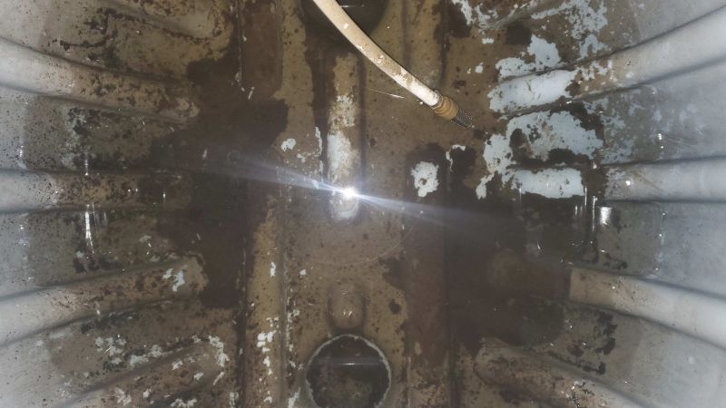

From the look of the inside Id say it has been perhaps only casually 'maintained' as is.
Before getting to the cleaning question may I ask 'does this have a self flushing diverter for the down-spout/inlet' to the tanks? If not, take a look online, there is buco info about commercial and (my fav) diy systems. What I like is how they help keep a LOT of junk out of the tank to begin with. If you dont have such yet plan on it for next season.
Having cleaned a lot of stuff since my youth back on the farm I suggest you tip the tank on its side and elevate the back/bottom so junk can run out. Then pressure wash the inside very well, set upright, add some clean water with some bleach and swish it all around and let sit a bit. Re-swish and dump.
Cap off for the winter and you should be good to go come next season when you have the 'flushing diverter' installed before the first big rains.
