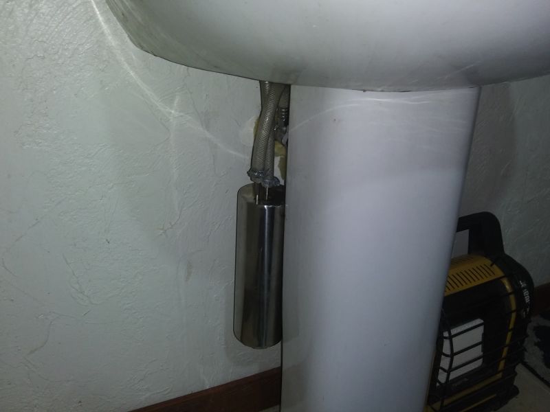

As I mentioned in another thread, the thought occurred to me to use a storage tank under the sink for hot water. So I tested the idea using a car radiator overflow tank. Like a hot water heater, the inlet runs to the bottom of the tank, the outlet at the top.
The plan being that, to fill the coffee pot or otherwise use cold water, use the hot valve, which fills the tank with hot water while the cold is filling the coffee pot. Then when hot water is needed it's at the ready, no waiting or wasting water.
Well it seems to work, although a larger, well insulated tank would be needed, something that might stay at least warm most of the day. Not really sure it's going to be beneficial in the long run, just something to try inside out of the rain we're finally getting.

Build a box or use some kind of can or bucket around your tank and surround it with spray foam from a diy can?

Good idea. I'm still not sold on this idea. It seems to work...
What little I've learned about tank water heaters is they fill with cold water from the bottom and the hot water comes out the top, which is how my little tank is but I'm not sure it's working that well, since it only holds about a quart and will fill and empty quickly. The water may be mixing up too quickly. A bigger tank might work better. Ultimately a coil of metal tubing instead but it would take a lot of it to make up a quart or two.

I think this will do more to save on hauling water but the volume is too small and poorly insulated to hold heat for any length of time. If you start with an empty tank in the AM and run water into the tank until warm flows a lot of that heat goes into raising the temperature of the tank. So that quart or so of water gets cooled during the save.
Suburban makes a 4 gallon heater as well as 6, 10, 12 and 16 gallon versions.
I think we had a topic on recycling the water from the hot line back to storage quite some time ago, but there was something that didn't work well for your etup. But I still think that is a better way to save water use; save the heated water for later use.

Yes, as I said this was only a test, since I had the overflow bottle from a car. So I didn't insulate it. The bottle did stay hot to the touch for for a couple of hours, as did the water inside. And I saved all the water it took to get it hot.
My thermos, about the same size, keeps water hot overnight easily. A half gallon thermos, with a modified top for inlet and outlet pipes, might work, if it could handle the pressure.
