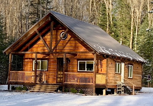

So my cabin has a well........410/420' deep - so the water comes out real cold, summer or winter
I have 2 x 20 Gallon water pressure tanks feeding the cabin - bathroom, kitchen and shower
The cabin sits off the ground by maybe 24-36" at places to allow for easy access underneath - thank god for that as I was able to get under and thaw out all the lines this weekend
The issue is that ALL OF THE PEX PIPES run under the cabin and are fully exposed and open
I have drain valves at the rear and the lines are supposedly angled to allow the water to drain out the valves when i open them up - when i tried that this weekend, the drain out valves where frozen and nothing could come out
We could not put any pipes inside the walls due to the vaulted ceiling and door heights/windows, etc. - we looked at it, but was not possible from what we could see during build out
There is no way that I can see to run the pipes indoors without some serious re-modelling - even then, not sure it would be possible
I may simply be stuck with what I have and as soon as any sign of below zero temps, shut off and blow out all the lines
I was just hoping for some ideas on how to potentially insulate these lines a bit to allow me to get through a "mild" below freezing temperature
Some of the guys in the area suggested the R38 insulation and then layer that with 1" ply - but that could create condensation issues I think and Brettny pointed that concern out
I dont see any way to heat the lines on batteries as the power use of the heat tape is too high for what I need
I think that I may just need to bring up my 6 Gallon jugs going forward when the cold kicks in - too much of a worry around freezing lines and potential that could create
The attached is a picture from last year, but lets you see the shape and the ceiling issue I have in terms of running pipes in the wall/ceiling, etc
