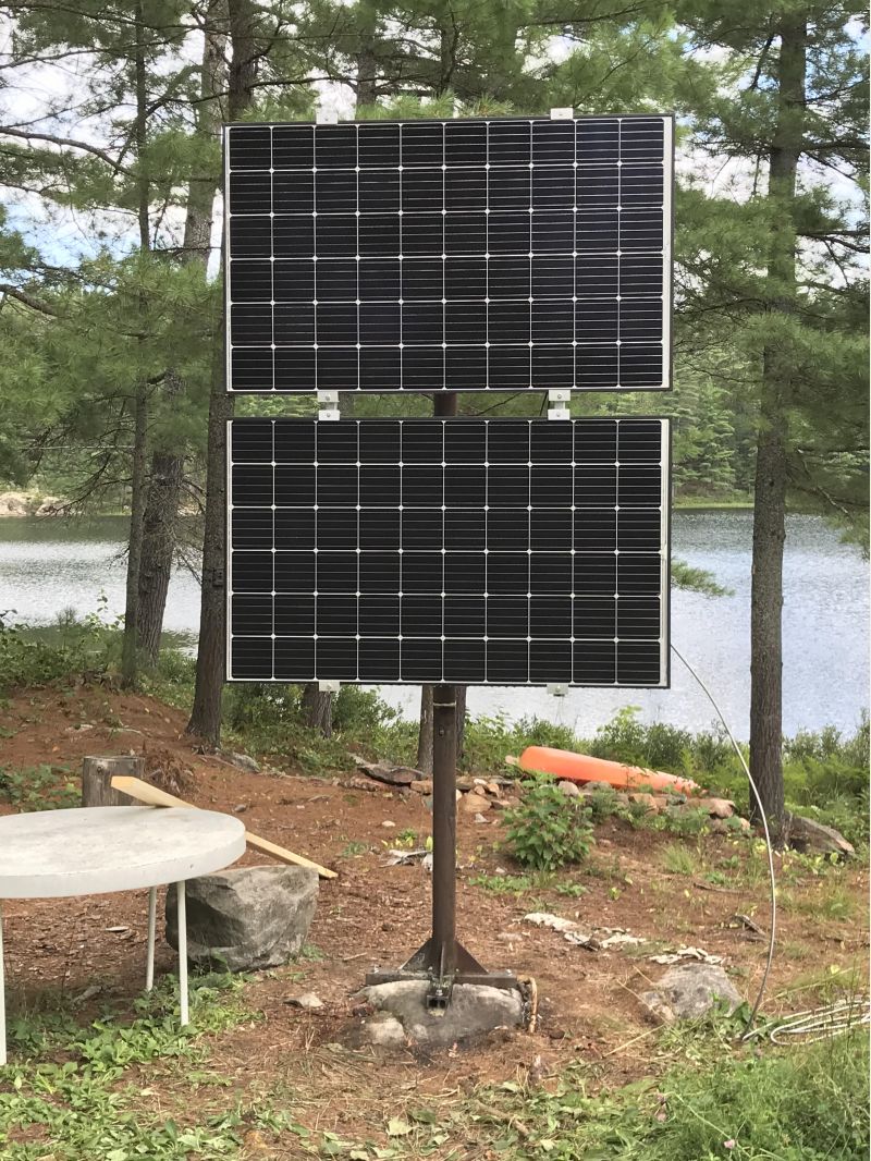

I built one on my roof from 2x3's that has two fixed settings, one for summer and one for winter. But now that I'm getting older I'm trying to minimize my need to go up on the roof, so built another one on a pole mount that rotates and tilts at any angle I want, so adjust it many times a day to face the sun and at least monthly for optimum angle. That was all from components at the local big box store
I don't have any detail pics, but its just some of the various steel components you can buy and nuts and bolts to make things adjust and lock into position.
