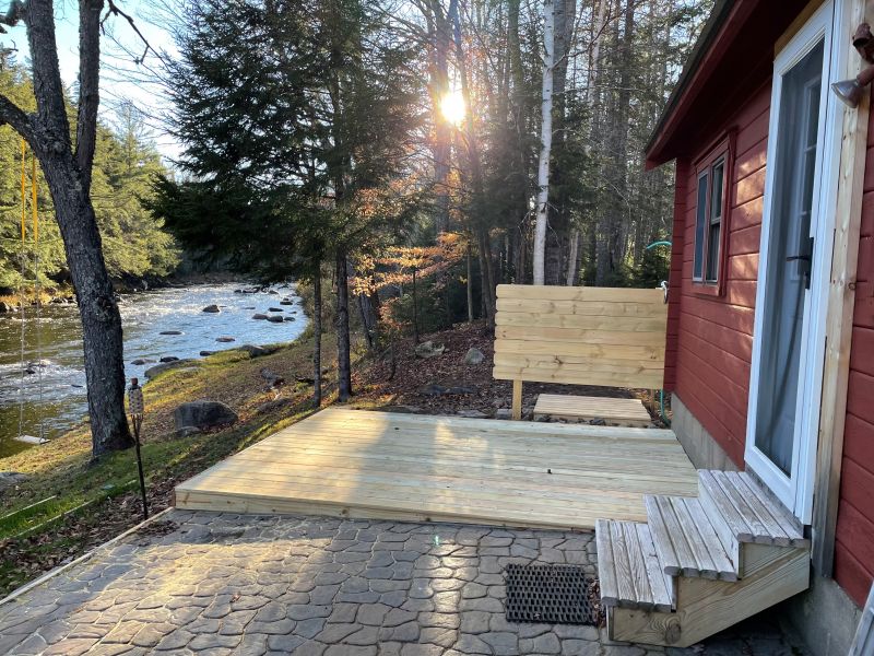

# Posted: 6 Dec 2021 04:42pm
Here's a photo of the shower, just behind the privacy fence. You can see the green hose sticking up!
# Posted: 6 Dec 2021 08:08pm
Nice place! Dont assume anything in the building. You need to find where that hose is being fed from before proceeding.
