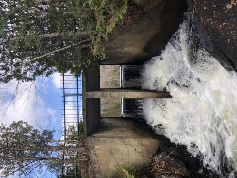

Hello, I bought a large spread of woodland in eastern Canada, far from electricity access points.
What is the best way to draw power from the dam in the pictures below?
A bit of info:
This November, the water was 8-9 inches off the flat ledge. Each sluice is 6ft wide.
If the flow table I found is credible, I get around 500 l/sec or 130 gal/s.
I can board up one of the sluices to raise the flow on the other side if that helps efficiency or lowers cost.
I was thinking a waterwheel would have minimal impact since the infrastructure is there, and there are no fish in the pond above. Guess I'd rather not manage a pipe running down the river incline: vulnerable to trees falling and leads away from the cabins. But open to penstock/turbine work if it makes more sense.
Would anyone know where to buy a waterwheel, or whatever power generation you think works?
All input is welcome!
Thanks!
David

I own the dam. It's not registered and the local council tells me it doesn't need to be. When I ask about authorization to harness the hydro power, they say I might ask the provincial (state) Ministry of Natural Resources. Will do, but I'd like to have a plan before reaching out.

No insurance, previous owner had the plot for 30 years and never insured anything. Mind you the stream doesn't hit a cottage for a few miles and then leads into a large lake. The dam was built in the late 50s and I was told by an engineer working for the power company that at this size it doesn't need to be registered.
But you are right gcrank1 , I need to have it inspected asap.
FishHog if you have a link to a waterwheel / turbine system that could power a few cabins and some equipment I'd love to read/watch what you found.

DavidM
# Posted: 21 Jan 2022 07:57pm
travellerw
H
Quoting: travellerw
I ran across this video on Youtube and immediately thought of this post. I thought I would drop this here.
Simple and relatively low cost, nice one, pumps are so much cheaper than turbines. I'm still trying to put together and get a permit for a waterwheel, got stuck on bucket size/shape optimization. Don't know how variable the water flow is, think I need to measure it in Feb to get a better grasp or low point. And then figure out what to do in April when the snow melts... simple and low cost is really tempting.
