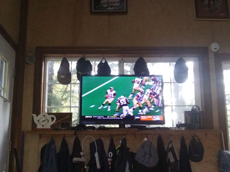

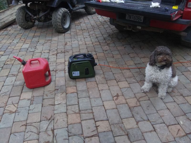

Got back from Vegas vacation itching to get back to serene cabin life, only my wife wanted to watch the football playoffs yesterday. Not to be deterred, I grabbed the TV out of the den, brought it out to the cabin and stuck it in a window. Gave me a chance to fire up the new mini generator I bought.

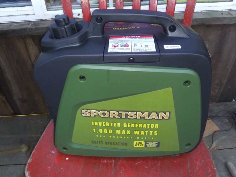

First the new genny, got it on sale at Tractor Supply for $200 during the holidays. 800 running watts. 22lbs., lighter than car batt and smaller than a 5g gas can. 40cc, takes under a cup of oil! Love it.
We watched the TV for about 3 hours. Could have used the cabin inverter but I wasn't sure the draw and wanted to break in the genny.

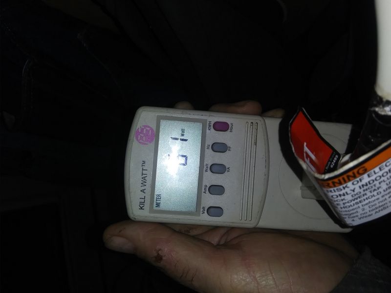

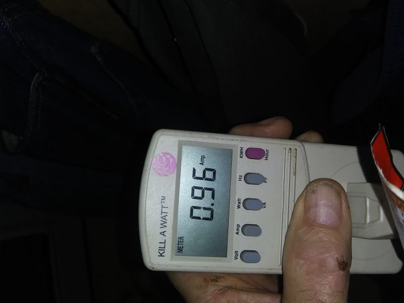

Found my Kill A Watt and tried it this morning on the inverter. Shows .96A and 61W. Shouldn't it be 120W? Either way lower than I expected. I do expect the wife isn't going to let go of this cabin add. 20220130_160802.jpg

What a cute little generator. And the dogs ok too

Your difference in amps and watts is likely explained by the power factor. The the Kill-a-watt reads this, too. (The hz/PF button)
https://www.youtube.com/watch?v=Tv_7XWf96gg
jhp

I had one of these for a while. Four stroke, low oil shutdown, lots of great features for the price. I didn't put a ton of hours on it but it was 100% reliable, easy to start and bang-for-the-buck factor super high.
# Posted: 31 Jan 2022 15:20
Is that the 1kw sportsman? I have had one for a bit over a year. It's for sure a fuel sipper. I'm getting about 9+hrs on 0.55gal (tank full). Its only job is to charge my battery bank, 12v at 30a.
There very very quiet and almost silent at the end of a 100ft cord.
# Posted: 31 Jan 2022 16:04
Yes, Sportsman 1000i, Brett mentioned having one awhile ago. Similar size and weight to the 2 stroke tailgaters but no smoke, quiet and pure sine. Yeah ran it for 3 house yesterday and barely used any gas.

Thanks Nate. Despite the beer analogy in the video being the best way to explain it to me, still confused on what's happening. I powered it up again, the PF says .55, so I guess that explains the difference, but what is it actually costing me at the batt bank, 1A or 60W? Quoting: Nate R Your difference in amps and watts is likely explained by the power factor. The the Kill-a-watt reads this, too. (The hz/PF button)

Paul did you break it in? Mine had alot of metal in the oil the first 30min of run time. And after the second change at 2 or 3hr it still had to much I washed out the crank case with brake clean and did a fill start and dump. I have 38hr on it now, I also put an NGK plug in.

I ran it for 20 minutes unladen, I think they mentioned that, though it didn't even rev up running the TV. Drained the oil, just a bit of black oil at the bottom. I am going to send in the 1 year warranty card though.
