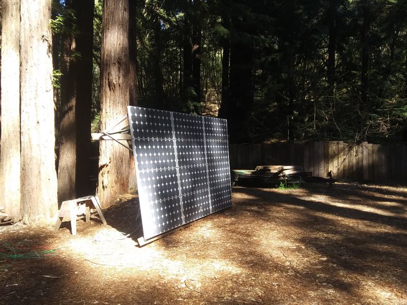

In other news, while I was hanging around watching my friend mill wood the other day I tilted this old spare array up and switched from 2x6 to 6x2, following your advice that parallel would work better in shade. And it appears too, though I need to play with it a little more. These panels are ancient, I was only getting about 1 amp in this photo.
Another thing I tried, since the panel voltage was now under 100 (about 38, down from 115), was a spare Renogy Rover CC, in place of the second BN in the shop. The Rover only showed about half an amp, so I put my DVM inline to the battery, on both controllers, and sure enough the BN delivered more current. At those small values and quickly changing sunlight it's hard to know for certain without several test sessions, which I may do.
I don't need much charging down at the shop, there is no continuous draw and plenty of time to charge.

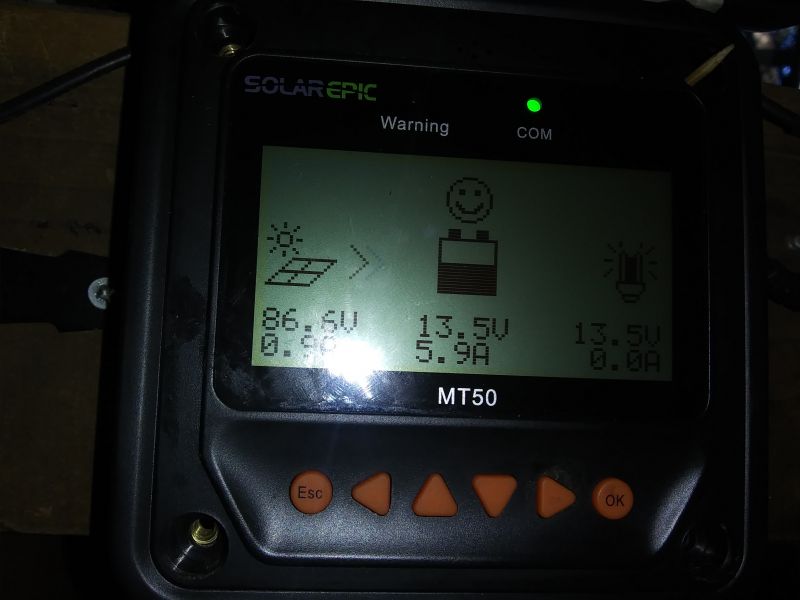

I was only getting about a 2 amp charge, with the MT50 showing 18 volts at the panels. I disconnected the panels briefly, reconnected, now it's showing 75 volt at the panels and 5 amp charge.
That is the exactly one of the issues! If I noticed the controller being "lazy" on our boat, I used to flip the switch on the solar input. Off for 5 seconds, then back on.

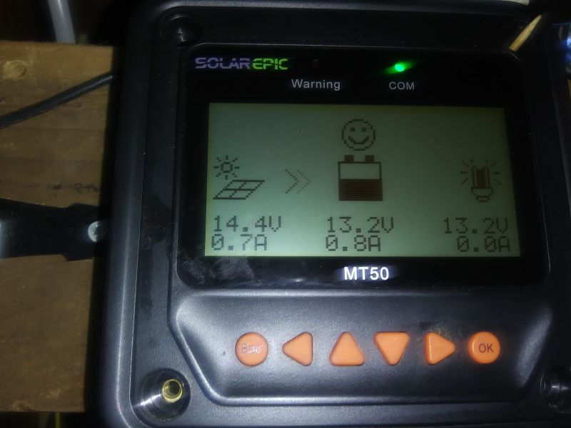

I duplicated the issue again today, with (poor) photos. MT50 was reading 14.4V .08A. Disconnected one solar cable from the BN, counted to 10, put it back. 86V, 5.9A at to the batts (batt voltage also jumped from 13.2 to 13.5). Very disappointing. What I will do next is put an ammeter in the line to verify the difference.
I have noticed unusual charging differences before but figured it was clouds, tree shade, bad connections..

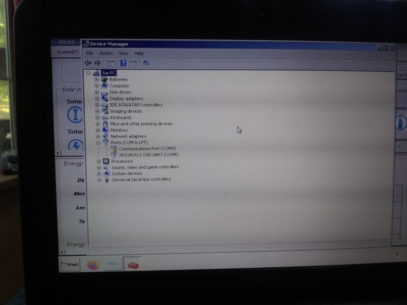

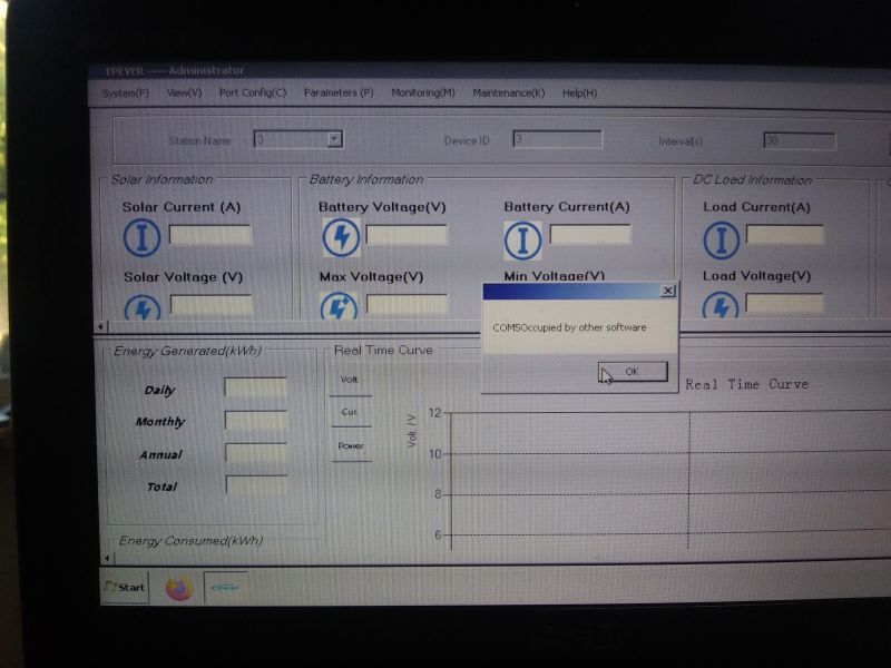

I received the cable to connect the Epever BN to Windows and downloaded the software. And, par for the course, I'm stuck in connectivity hell. I connected the cable, to both, got an unable to download driver message. When I plug the cable in, XR21B1411 pops up in Device Manager, some kind of transmit receive thingy. So I found the driver for that online, downloaded and installed. Now it shows up on COM5. But the Epever software says COM5 occupied by other software. And no info from the CC is showing up. So I'm stuck..
Remember going through any of this trav?
On the bright side the CC seems to be behaving itself lately.
travellerw
# Posted: 25 Feb 2022 04:42pm
Oh ya.. It was a PIA and the software looks like it was written as a high school project.
Here is some good instructions
https://www.diyrenewable.com/blog/post/how-to-use-the-epever-pc-software-for-charge-c ontrollers/
I remember this being KEY!
In the left menu, click Ports, then double-click on xxxxxxx USB UART (COM3). Select the Port Settings tab, and make sure that the RS-485 checkbox is checked. If not, check the box and press OK to close the device window.

Whew, got that right! Well I finally got it working after two hours of farting around. That's it for me tonight, tomorrow I get to explore all the monitoring and graphs and stuff.
