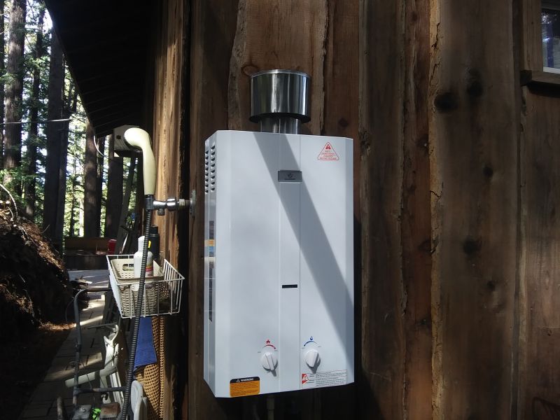

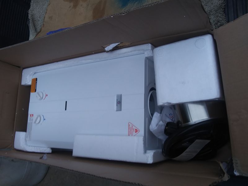

Scored a new L10 from a guy on CL, he hadn't realized it was outdoor install, though it does look it could be ducted, unlike the L5. It has an advertised flow of 3gpm, twice the L5. Hoping this will cure the pump cycling.
# Posted: 1 Mar 2022 05:35pm
Got the L10 installed last night, first shower today. On the plus side, much stronger stream, no pump cycling. Feels almost on par with my city house. On the downside I had to track through the cabin and outside around back a half dozen times, naked and wet, to get the knobs close to where they need to be. Sorry no photos. I'll get it, only took me about 6 years with the L5.
