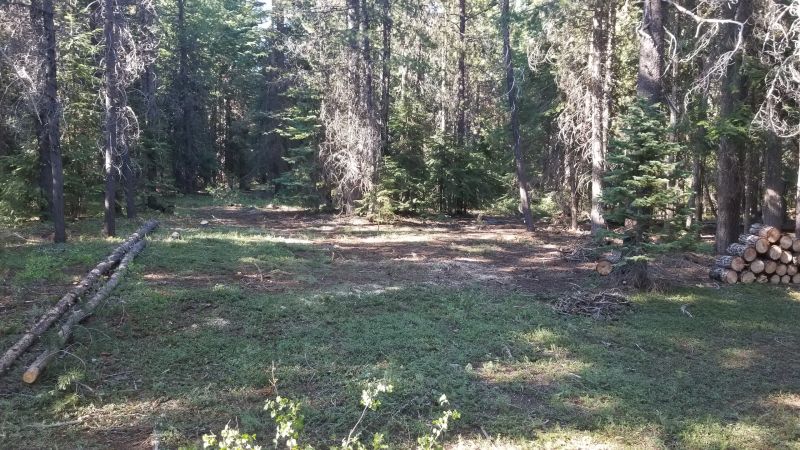

# Posted: 22 Feb 2022 09:24pm
This is our purposed cabin site.
Cabin site
Cabin site
