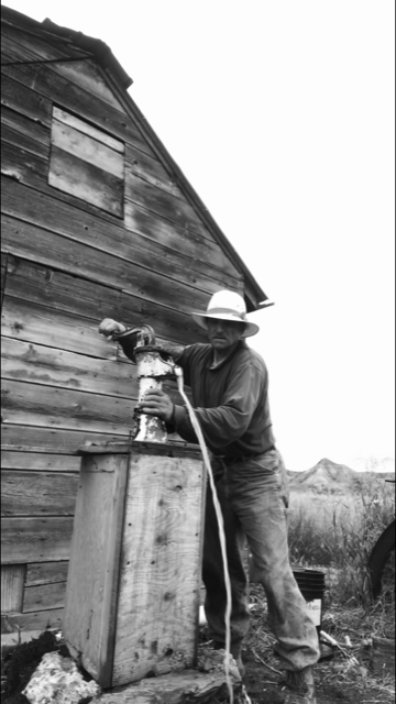

# Posted: 16 Jul 2022 11:22am
Installed a pitchah pump on the fourth of July and brought water to the surface.
# Posted: 16 Jul 2022 08:30pm
