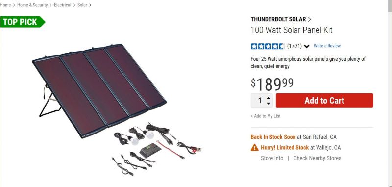

# Posted: 7 Mar 2022 10:49am
Quoting: Llucas
We are keeping it simple our cabin
That's what I said...
I started out with the HF kit, panels, a charge controller, USB ports and two 12V led lights with cords (and a third port), usually on sale for $150. I still have it to charge my tractor batteries, been completely reliable.
