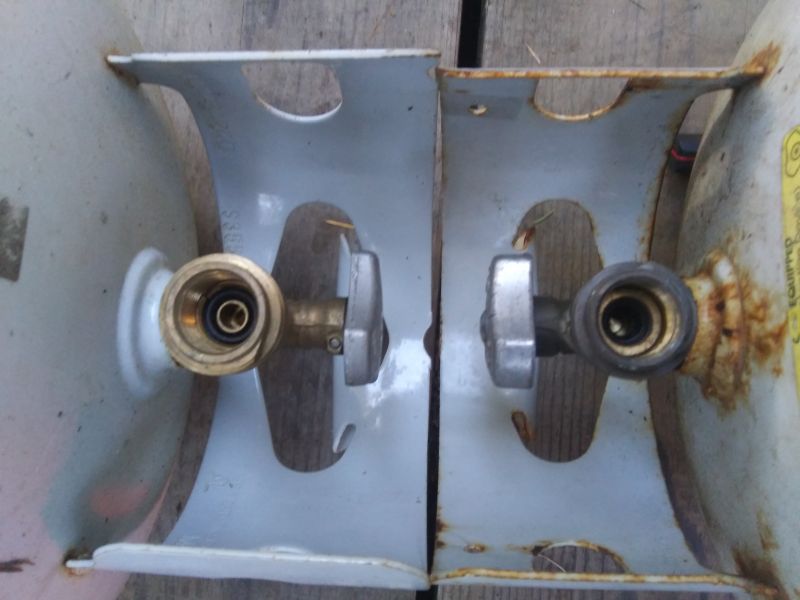

Got a tank, the rusty one, that won't seal up. I'll exchange it but should I be looking for the style on the other tank?

I think the nice tank is the current type, but maybe check what new tanks have next time you are in a store selling them.
We have an exchange close by, the fill company recerts the good ones so there is quite a range of ages in use. They are also one of few that actually do 20# in a 20# cylinder! I exchanged for a newish one (look at the date on the collar) that still had about 1.5 years to go from date of mfr, I can get it refilled anywhere now without the 'inspection/recert' fee.
I upgrade my tanks whenever possible. By picking my own exchange tank from the bunker I get the newest style with only the exchange tank price, not having to buy a new tank and fill it.
Btw, the old style POL internal left-hand thread fittings had a big, smooth bull-nose all the way to the end. Do Not use those in the new style with the safety valve, use only the new style POL with the rubber o-ring and the little cylindrical tip (that tip is what pushes in on the valve's internal safety valve. Using the old POL fitting will wreck the valve and those parts are not owner replaceable. Be aware there are new style POL's that still for use the internal thread which is in all the valve assemblies that also have the big, coarse quick-change external thread. They also work in any old-old style too.

I remember the internal LH thread couplers. All mine now are the external thread. I think on this rusty tank there is an O-ring deeper inside that seats on the straight part of the coupler, instead of on the ball portion like the other tank.
I found an O-ring that fit in there and it's working with no leaks. It's a full tank so I want to use it before I turn it in.

Your old one looks like it's got a quad ring style rubber seal? Looks like a square O ring. I had one leak when in use..I looked at the rest of my tanks and all the one that had O rings like that also had cracks. All where also in date. I quickly used and exchanged these tanks.
# Posted: 27 Mar 2022 09:11am
Yes that's what it has Brett. Time to give all my tanks an inspection. The rest are empty, I went through about 5 this winter, mostly using the wall heater.
