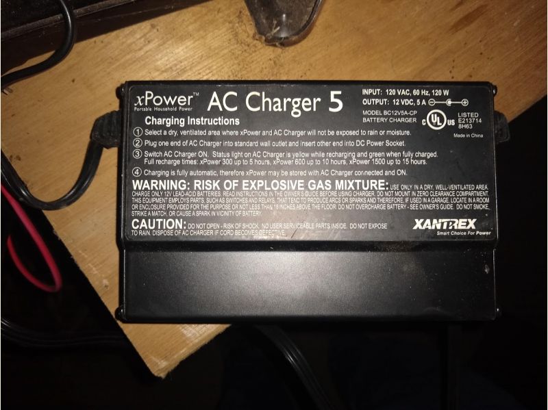

I just acquired (free) a powerpack that is pretty old and has been neglected for some time. Xantrex Xpower1500. It has a built in inverter, a DC port and regular battery terminals.
I checked the voltage and it was ~10 volts. I hooked up the charger that comes with it (5 amps) and left it charge for about 18 hours. At that point it was still charging and appeared to be taking a charge. I checked it right after I took the charger off and it was reading approximately 12.5 volts. I let it sit for a few hours and tested it again, 11.5 volts. I turned on the AC outlets and tested them, got ~98 volts.
I'm not sure if I'll be able to bring this thing back to life or not, but I was thinking perhaps I should bail on the 5amp charger and put my 1.5 amp trickle/maintainer charger on it and leave it on for a week or two and see what happens. Good plan? Or should I keep the 5amp charger on it?

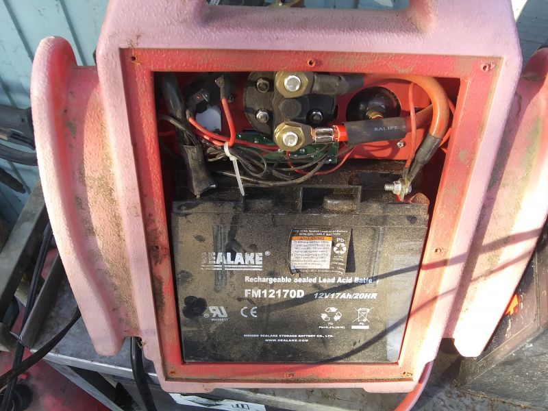

Co-incidentally I was just about to trash my original jump starter pack (I have a couple of lithium ones now) but figured I'd take it apart first for parts (only 8 screws..). I checked the big SLA, it was around 12.5, so I put a charger on it. That was a week ago, and it's holding a 12.6 charge. So I guess I'll keep it around, and probably find some use for it.
# Posted: 6 Apr 2022 06:32pm - Edited by: gcrank1
Paul, I ran mine on its own charger several times, didnt get past a certain point. For all I know that charger may have never really fully charged that SLA bat.
I think mine may have got the best results after I hooked up my smart charger that has a recondition mode, and let it go for days. My charger has a 2, 10 and 20 amp selection so for that little 20Ah bat I used the 2A setting. I dont use its oem charger any more.
It is just a little handy power pack for me, I took off the jumper cables and wired on a SAE cable & connector for easy plug in of those kind of accessories.

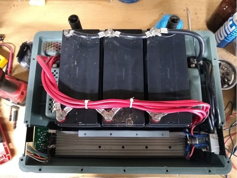

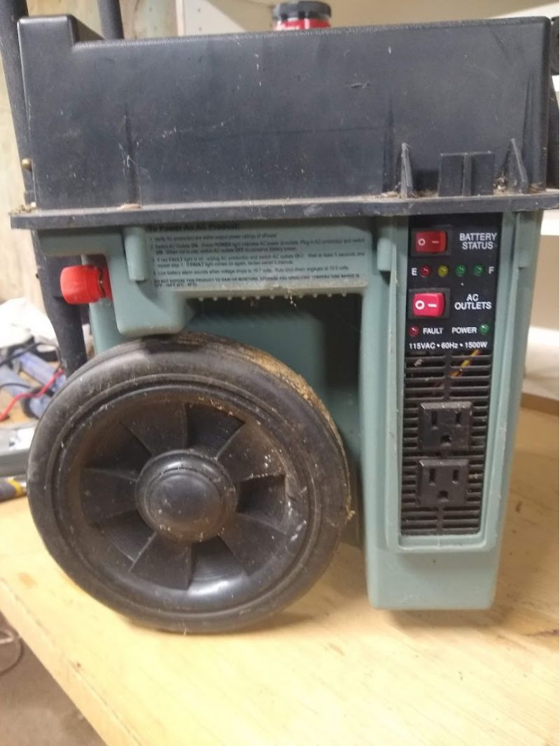

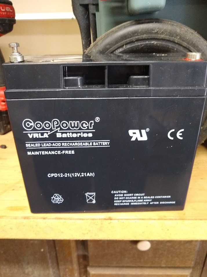

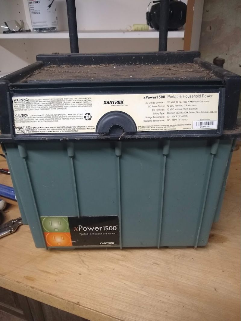

So I've tried charging it 3 times now, each time after a rest period its back down to 10volts or so....So I took the lid off, three small 20AH - 12V batteries, wired in parallel.....
Going to see what I can find that will fit in its spot....Thanks for all the advice....Couple pics attached..
# Posted: 8 Apr 2022 03:44pm
Looks like a typical 21ah SLA battery. They should be about $50 each on amazon.
# Posted: 8 Apr 2022 05:39pm
Yep. I used to get those for free from a pal who changed them out on a calendar cycle (not usage or condition) for big companies, used it alarm systems, backup power etc.. Always had plenty of life left in them.
Also about the size of a Harley battery.
# Posted: 8 Apr 2022 05:50pm - Edited by: gcrank1
Remember, the 'lead acid' of any type bats have that max 50% dod/soc or you kill 'em, much better at 25-30% dod (70-75% soc).
So, those 3 20Ah bats were 60Ah when new, then pretty quickly degraded to 50Ah.
That is 25Ah at the 50% MAX, 12.5Ah at 25%.
If you bought one 40Ah LFP you would get at 40, even a 20Ah would give you 20, well more than the 12.5.
Deduct the price of replacement LA bats from the price of an LFP to see if you can stand the extra spent, then figure the LFP will last easily 2x as long.
