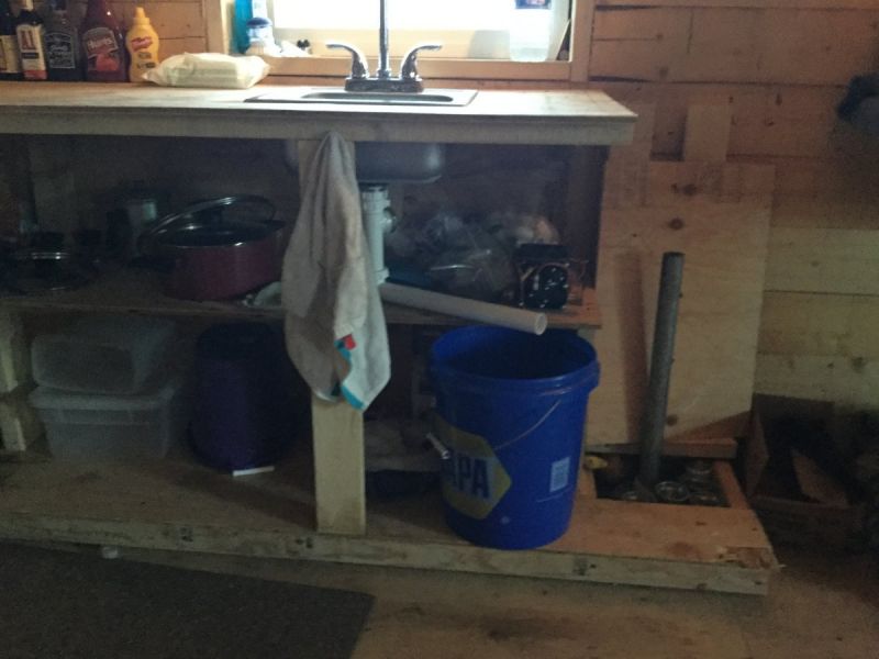

I started pounding in the sandpoint well at the cabin. Got near 4-5' in. Then it hit the harder ground. The hill or kettle moraine that the cabin is on is mostly smaller 3-6" round rocks. Left from when the glaciers retreated.
I've been trying to come up with a way to finish pounding the 2" pipe another 15-20' down. Without having to rent a jack hammer at 85 bucks a day.
Here's my current idea, theory. Mount a 12v winch above the pipe from the ceiling. Make up a sacrifice hammer pipe. Well pipe is 2". I have a 2"- 1" bell reducer and a 12" pipe into that.
A 12" long x1" pipe that a 1-1/2" pipe can slide over to act as a guide. That is the well pipe end.
The hammer end would be a 12v winch from the ceiling that would pull the weight up probably 5-6'. Then put the winch in free spool and let the weight drop. Being guided by the larger pipe. The weight, i would have to have everything flown out so that has to factor in. I figured that I may as well bring out stuff that would be nice to have there. I have the corner bit off of a
D-8 blade. And the corner bit would make a good anvil. Also have a 12" piece of railroad track.
I figured that would be a good start and it's what I have.
So what do you all think ? Or if you've have other ideas or ways to upgrade what I'm thinking I would appreciate any suggestions. I'll post a picture of the current status. It's the 2" galvanized pipe.
Again thanks for any help
Well pipe
Well pipe

I don’t think a free spooling winch will be free enough to allow you a good hit. Need some kind of a disconnect
# Posted: 11 Apr 2022 06:46am
You cant pull the free spool knob/lever on winches while theres a load on it. Just to much load on the system to release.
5in rocks I wouldnt even attempt to drive a well. Even 3in in claybi wouldnt try.

I agree about the winch.. You won't be able to pull the release when its loaded.. It also won't free wheel enough for a good hit. A quick disconnect would be required.
As to weight.. Are there any good sized rocks around? Instead of flying in weight (expensive), you could find some locally.

The winch I have will free spool under a load. And it spins pretty freely. If I could figure out a better release it would be better. The winch would be slow too.
As far as weight. The hardened steel dozer bit would be handy to have as an anvil out there. Weight usually isn't a problem on the plane. Capacity for loading is limited.
As far as being able to pound the pipe in and rocks. Well it's a gamble, but I believe I can do it. Really nice to have potable running water in the kitchen. But heck building and maintaining a remote cabin is risky in itself. And the reward will be handsome if we get good water.
The pump I had claims a 25' lift capacity using a 1/2" water hose. Figured I could put a small section line on if it didn't work. There is also 12v submersible pumps that will fit down a 2" pipe.

Anyway, can you put something down the pipe you have in there now, with a point, to break up the rock that's in the way? Or drop some explosive..

Cathead (capstan) winch with manila rope. The winch motor just runs and you put a loop or two around the cathead. With no tension on the rope the cathead spins and the rope just stays stationary. Put some tension on the rope and it grabs the cathead and starts to pull. When whatever weight you have attached to the rope reaches full height, release the tension on the rope and the weight will drop. Put tension back on the rope again and repeat.
I don't know how many hours I've spent watching a driller do this to drive in a splitspoon to collect a soil sample for me to look at. Once you get the rhythm down, you can bang away quickly and with out much effort.

Why not try pounding in a different location to hopefully not hit a rock? You could beat the point down outside then pipe it back inside the cabin.
