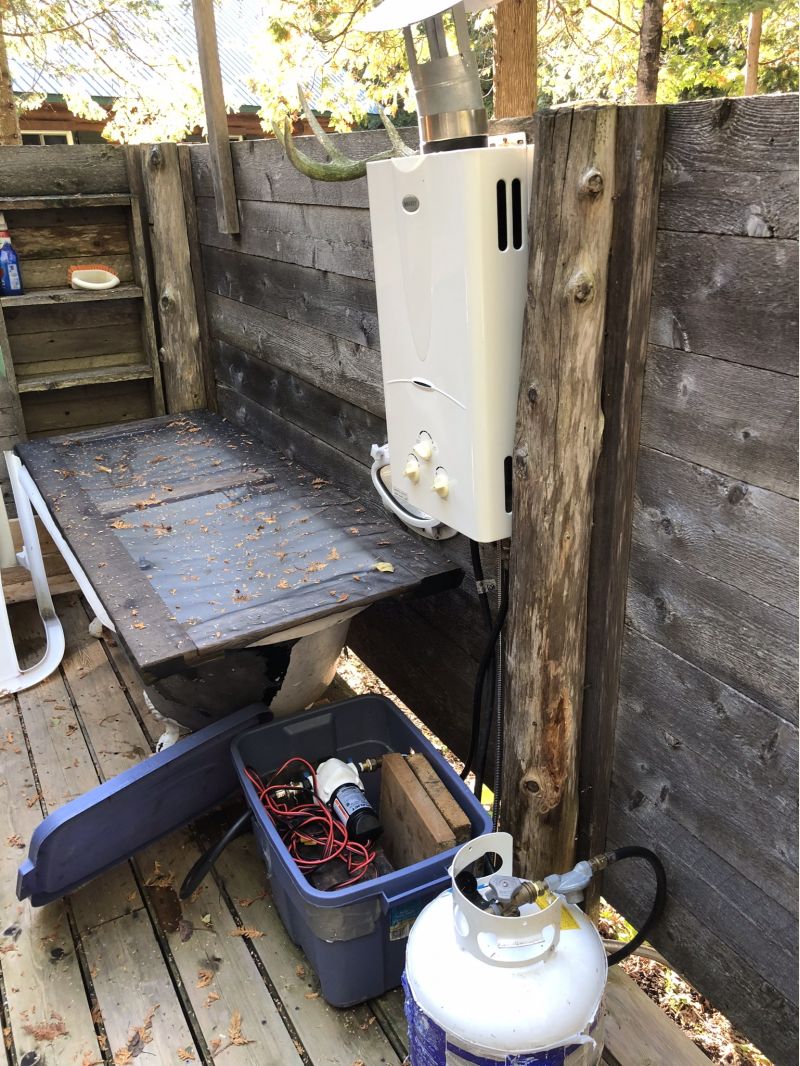

# Posted: 10 Dec 2019 09:21am - Edited by: silverwaterlady
Our furnace in the city finally aged out and the central air. The gas water heater was almost at that point.
So to save money and because we think it’s kind of a money waster to keep 40 gallons of water hot 24/7 we got a tankless for our city home.
We love it. It takes about one extra minute of running the water to get it hot. But after that we have unlimited hot water.
We can finally turn the hot water on when someone is taking a shower and not have the water turn cold. Three plus decades of not being able to do that? It changes everything.
Our tank is made to be able to handle two separate appliances or one shower and one appliance at a time.
Only problem with that right now is that our plumbing is original to the house.
We would have preferred to get the plumbing done first but our furnace went. Came home from the cabin, turned it on and nothing.
Getting copper plumbing after the holidays.
The only issue and it was pointed out to us before we switched over is that these heaters cannot supply enough hot water for showers that have multiple shower heads. The body, rain shower combos. Or huge tubs. The tank cannot keep up.
Other than that you are good to go.
As far as plumbers or HVAC experts not knowing much about them or being unable to repair them, that may be true up to a few years ago. More people are having them installed and the companies that do it have been trained.
I know this because when I inquired a few years ago about having one installed the companies I have a relationship with didn’t know much about them.
There is not much to break on these units. The most important thing to do is to have it serviced and cleaned once per year which I do with my furnace. Same company.

# Posted: 11 Dec 2019 08:35pm - Edited by: silverwaterlady
Well okay than. Here you go.
I have discussed what we use at camp many times over the years off grid in the summer. It a great unit. Used it four years with no issues. We do have a NIB backup just in case.
We love it so much we got a electric, gas tankless for our city home. Thought there might be a interest. Since I know many of us are gone from our city homes with stale water sitting in a tank for months.
One time we came home to 40 gallons of water on the floor. Of course we turn the water off. If we had not our entire house would have been destroyed.
So now this is one less thing to worry about.
