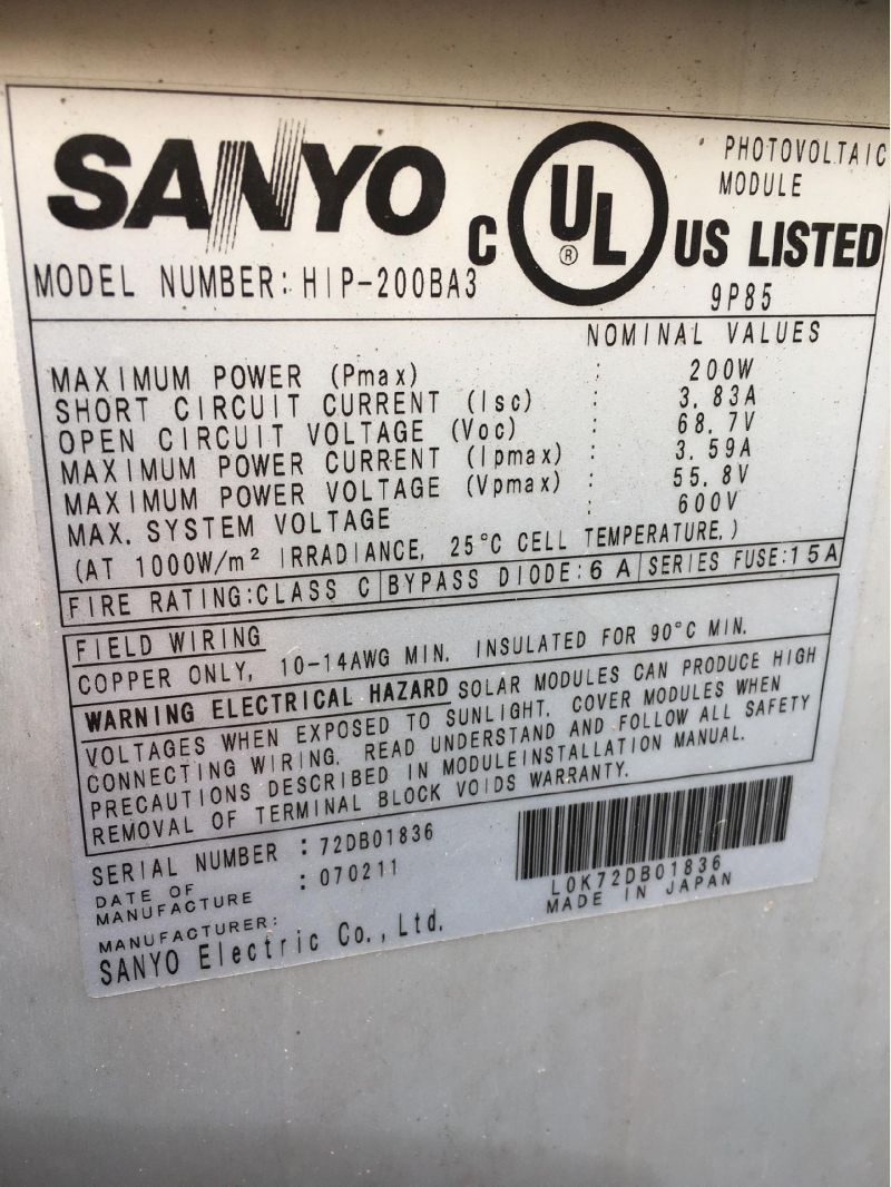

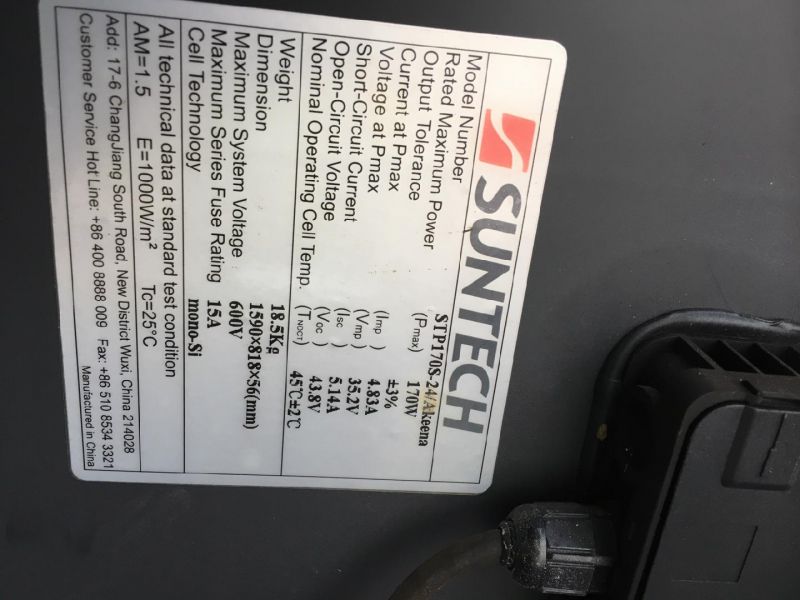

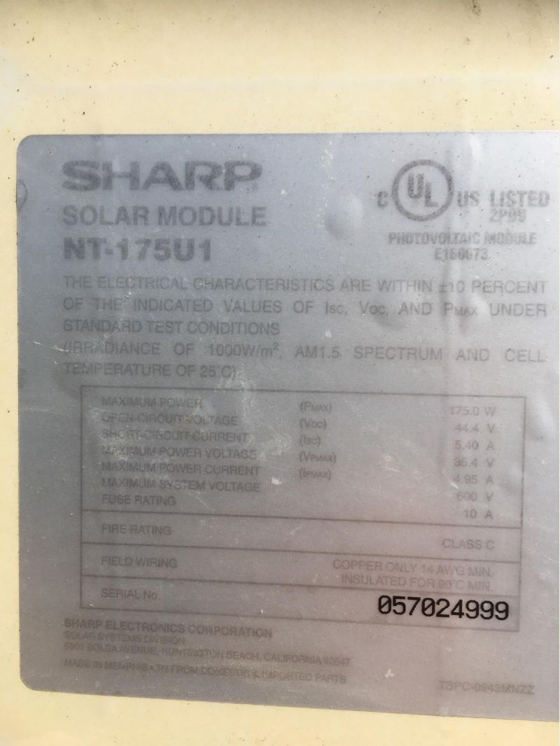

Link44
# Posted: 2 May 2022 06:32pm
Here is the solar panel info.
travellerw
# Posted: 2 May 2022 09:12pm - Edited by: travellerw
Those Sanyo panels are %19.4 efficient. They seem to date from about 2008-2011. They would be my choice for sure.
Not sure where the panels were used, but its possible they have lost some capacity. They might only produce %85-90 of their rating now. However its also possible that there has been no degradation (I had 20 year old panels that still produced more than rated). If you view them you want to view them in good light and look at each of the cells for any brown discoloration.
Now be aware that those Sanyo panels are high voltage (like 65V) and designed for rooftop in series. 2 panels in series is 130V and you need to be careful as 130V DC is SPICY. You will need to spec you solar controller properly.
I'm curious why these would be your choice. Any thoughts for a charge controller? I also dont want to just buy panels and then have issues piecing a system together.

I'm curious why these would be your choice. Any thoughts for a charge controller? I also don't want to just buy panels and then have issues piecing a system together.
The other panels are less efficient (16ish and 18ish), so you would require more square footage for the same wattage. The other panels are also older tech (2005-2010). Those Sanyo panels are also a good known brand. The higher voltage is more efficient for an MPPT controller to handle.
As to a controller. I'm partial to Victron as they are reliable, reputable and well priced for what you get. One 75/15 could handle 3 of those panels in parallel.
