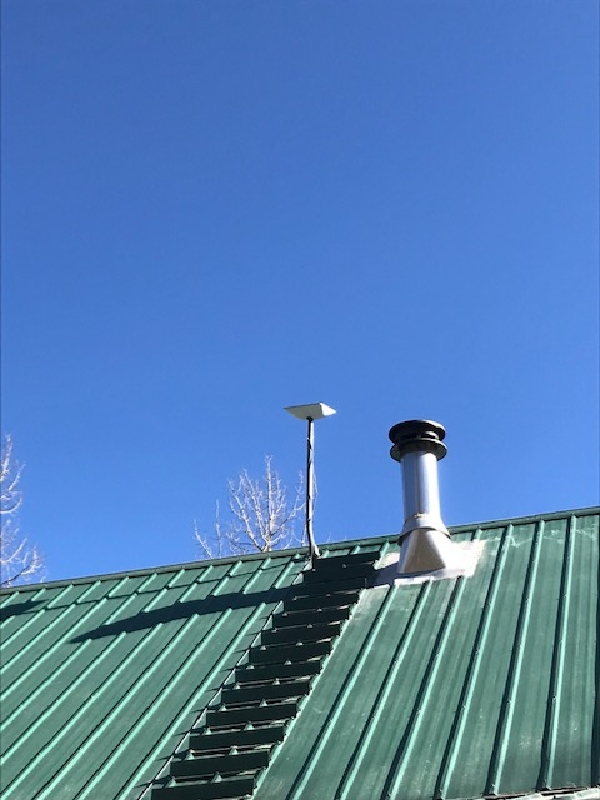

 Well we have had Starlink up and running now for about a month. Have to say I'm impressed!   It is mounted on a 38" Winegard mast that is lag bolted to the 2x4 purlins under the metal.... lots of silicon! Very sturdy... so far has held up to +70mph gusts!
 I used the app to scan for obstructions per their advice... seemed like we might have a little interference but didn't look bad..  we worried about when the aspen leafed out that there might be trouble but with them 95% full leaf, Dishy is still saying "no obstructions!"  We have taller trees to the east and west but the satellites travel sw-ne and nw-se diagonally.

 We seem to be high enough on the roof, on a 38" mast to avoid tree interference.  We wondered when the trees leafed out if we would have trouble but the aspens are in full leaf and Dishy stills says no recent interference every time I look.  Sweet!

 THIS is the mast I used.  I ordered an adapter off etsy but wasn't that happy with it.   I would buy the adapter from Starlink.
 Quoting: zorro Do you think i could simply bolt the antenna to the top of the eaves on the cabin, rather than using a large mast?
 Depends on your skyview .
| jsahara24 Member
 | # Posted: 18 Oct 2022 08:44am Reply
 I repurposed an old direct tv mast to mount my starlink.  Had to fab up an adapter but it was simple...Something to consider if you have any old dishes laying around.
 And yes, completely depends on your skyview.  In PA we need a northern sky view.
