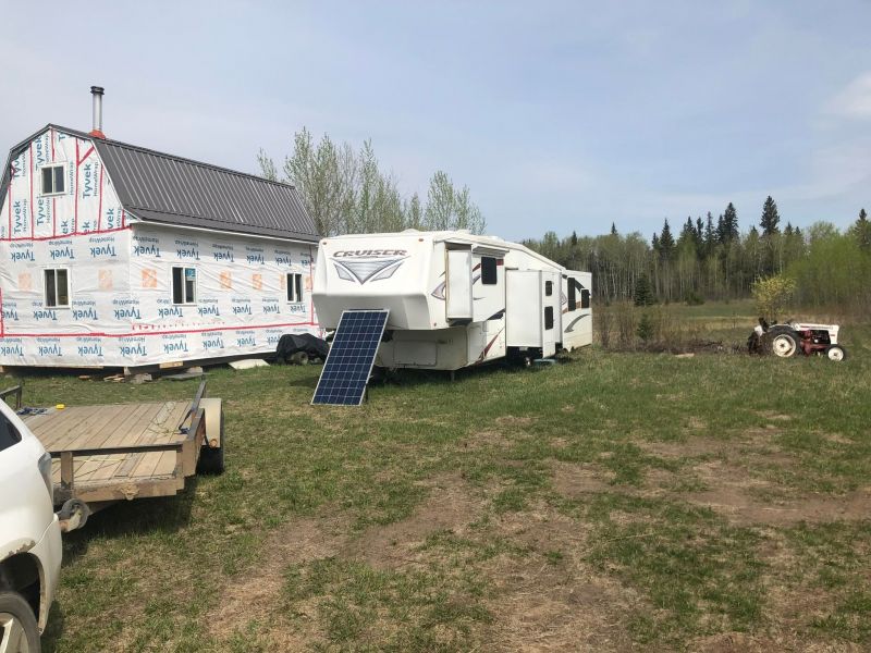

I have been working from my cabin this week so I can try and get the mudding finished in the evenings. It really bothered me that I would be running the generator a bunch to ensure my hardware was up and running. Then it dawned on me, "Hey dummy you have all the gear for a solar system, why not use it?"
So I brought one panel, the controller and a small inverter with me. I used my "calibrated" eyeball to set the angle on the panel and drove some iron into the ground to secure it (the top is secured to the 5th using ratchet straps). Bam, a Ghetto solar setup.
Its easily provided enough power for me this week. However there is some tweaking to do as I have only seen 265W MAX out of that panel and its a 360W panel. I don't think the angle is right and there is some shading.
Anyway.. I thought I would post a pic!
# Posted: 26 May 2022 11:15pm
Shading BAD
Angle not so much
Ime, 70-75% out of a panels 'under ideal lab conditions rating' is pretty good.
Moving the panel orientation through the day will capture a bit more hours.
Not bad results for rural ghetto

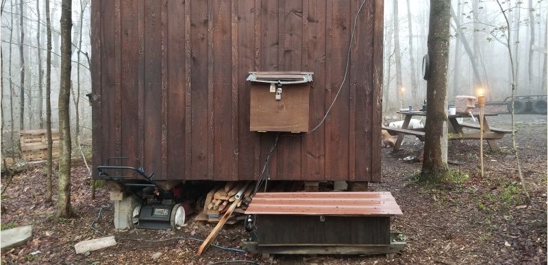

# Posted: 27 May 2022 08:54am
My whole setup is temporary..I knew that going in so I built a exterior box to hold the inverter and CC. This weekend I'm going to add another 235w pannel to the two I have.
Batteries in there own box too. If/when we ever start to build a real cabin I can just screw the setup on the side of the cabin.

Wow, Brett, how do you get enough sun? Looks like a lot of cover there.
Put the shed on the south end of the "clearing" and aim the pannels at the opening in the sky. I only get 3hrs of sun on the pannels in the summer. I actualy get more useable sun in the winter with no leafs.

Well I'm happy to report that one panel was able to provide enough power for my lights (all LED), my laptop and my MIFI device. Even at the reduced numbers I was seeing. Its a tough pill to swallow as in the Carrib we would see full panel rating (and often over the panel rating). Even cheap Amazon panels would often produce more than they were rated for. The sun strength and angles are just different up here.

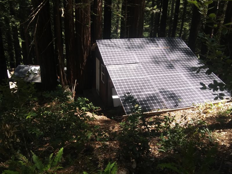

Somebody mention over-panel?
At left you can see a panel on the cabin roof. Six more there.
