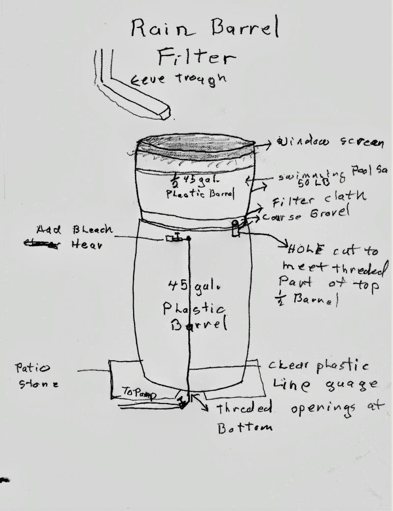

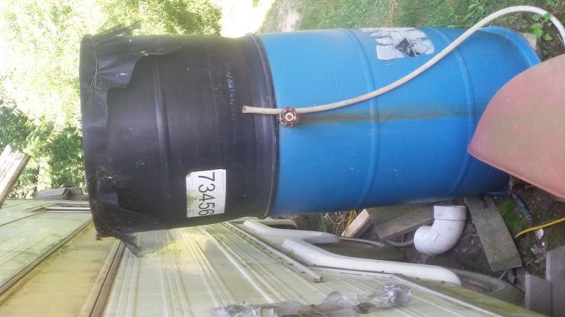

# Posted: 6 Jun 2022 08:47pm - Edited by: Just
Been up and running for ten years cleaned it the first year no need I learned. Water is clear before treating so not much chlorine needed . We drink it after boiling.

# Posted: 7 Jun 2022 01:24pm
A sand filter is great, and a freeze-friendly system is even better!
I have a diverter but no sand filter yet. If you do use a half barrel with the sand filter drawn above, consider adding an overflow as big as or bigger than your downspout pipe. The water will pool and go slowly through the sand, so you might get overflow in a good rain.
I add 1/4 cup non-scented bleach per 55 gallons (sorry metric folks!) You should have a bit of chlorine odor but not overpowering. If other odor or no chlorine odor, you may need to add more chlorine. You might give the chlorine a half hour or longer to do its work. The colder the water, the longer you'll need. I try do add chlorine as one of the first items when I arrive at the cabin. I let my wife unload the car...
