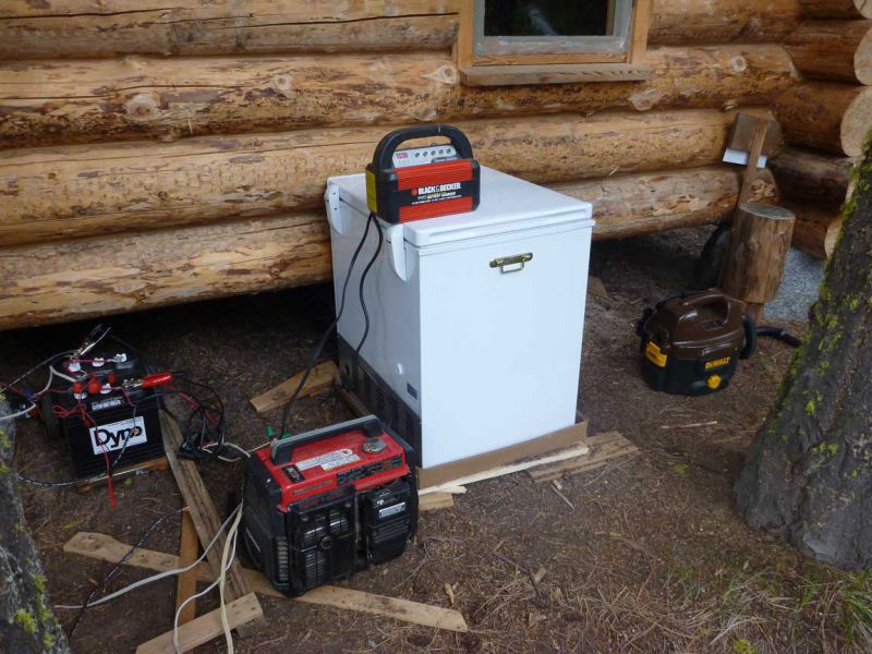

OK I ordered this refrigerator from Northern Tool. We'll see how it goes. My cabin is so small I'll probably have to keep it outside.
Funny how they call it "Solar Powered". If you want it to work anytime other than mid-day, a battery is required.
Sundanzer 1.8cu ft refrigerator, 114Watt-hours/day

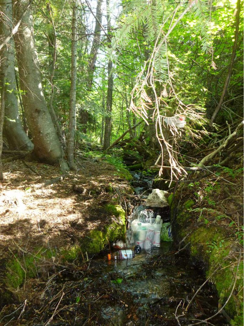

Photo of my "current refrigerator". It's 45 deg F, ready for guests!
Creek refrigerator.
Creek refrigerator.

I got the Sundanzer, and am using it at my cabin now. It is BIG, nd the size is mostly due to thick insulation. It appears to have the same Danfoss compressor as the "Truckfridge CF49" that I have in my camper van. It's very small inside but the entire unit is so big I'm thinking of building a little shed for it and using it outside.
Seeing how big this $730 fridge is,,,, compared to how small my cabin is. makes me wonder if it would have made more sense to spend the +$400 on more solar panels up in the tree (lots of space outside in the tree!) and buy a smaller, cheaper electric fridge. Or, a 3-way that runs on propane.
Also the Sundanzer does make noise. Pretty quiet, but still, there's the "tink" when the compressor starts up, and the compressor motor noise that goes on for a few minutes. It's so dead-quiet inside my cabin at night I don't think I want to listen to that device. Another reason to keep it outside. Since I have a tiny one-room cabin, efficiency means more that watt-hours consumption.
Other details: The SILENT 3-way fridge that Bugs has; operates on a 36 degree differential, which means that if it's 86 degrees outside, then the fridge is 50. And if it's 66 degrees at night, stuff could freeze inside.
The SunDanzer has NO freezer compartment (no ice cubes or popsicles). Lots to consider here....... But I have this one, will see how it goes.
Sundanzer DC50 1.8cu ft refrigerator, 114Watt-hours/day

ps: Love your "natural" fridge.
TomChum
# Posted: 29 Jun 2011 01:55am
Thanks bugs, good info. The natural fridge has its benefits...on the downside it's about 600 feet away from the cabin.

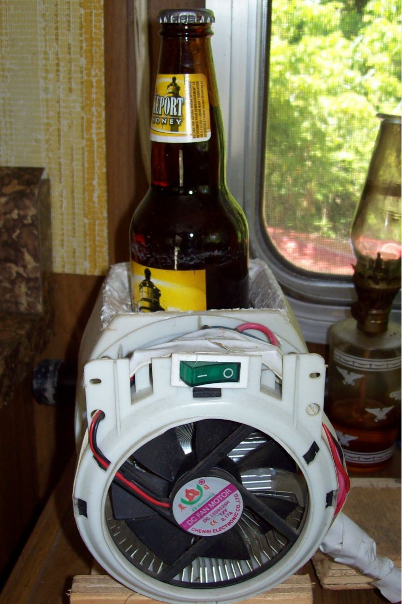

One beer fridge . Made from the guts of a small discarded water cooler!! will cool one drink every 20 min. gets a fair amount of use at the cabin!! the lable sayes 7 watts ?? don't know how it works !! have to ask M-DON that ???
one beer fridge
one beer fridge
