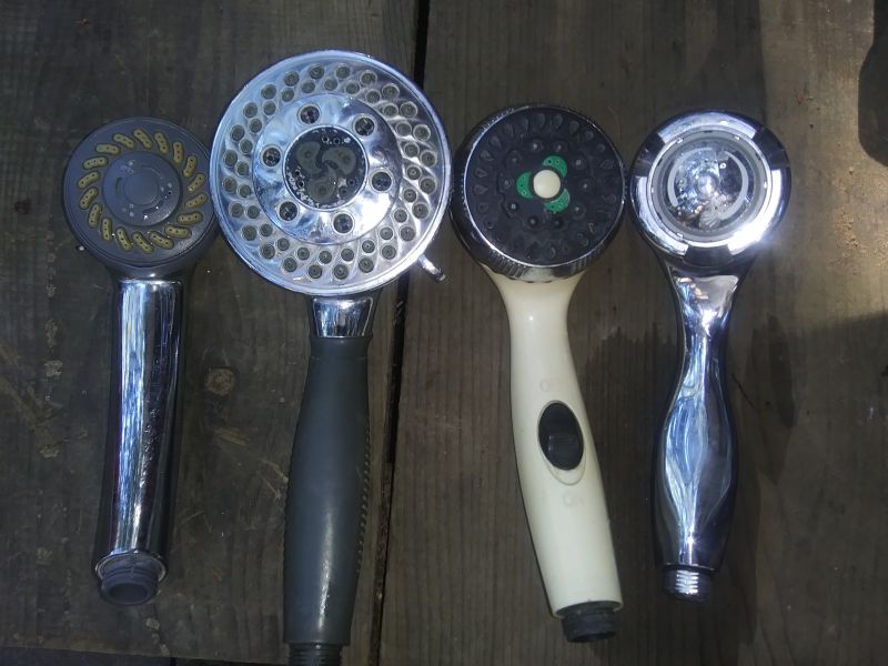

Here's my current crop of cabin shower heads, all adjustable. Some do work better that others.
I have something in the works for next week..
