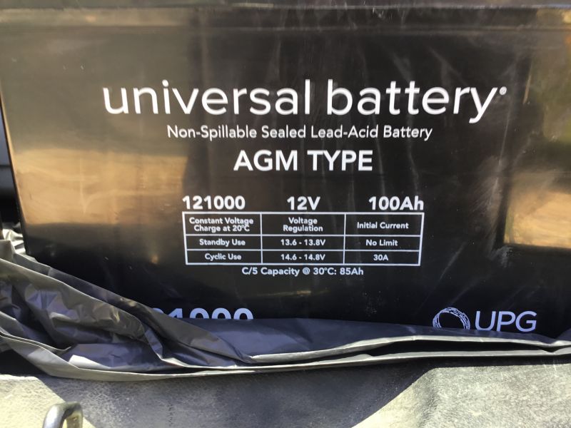

I might as well purchase new. But? I can go back to Amazon and purchase two more. OR?
I can get some recommendations here and maybe get better? I am not going to cry poor mouth. But please keep from being like Uncle Sam, spending my money!
Really, total of three lights. One used from sunset to maybe 11:00pm. iPad. I can recharge hearing aid and toothbrush during the day. I turn my phone off when I arrive. Use Jenny for microwave and coffee pot. Bar b Que used for cooked meals. Below is what I purchased.
Thanks everyone.
# Posted: 2 Jul 2022 08:25pm - Edited by: gcrank1
AGMs are kinda pricey, imo. How about the Walmart 'marine deep cycle/leisure' battery (just one), about 100Ah 'rated' (but more like an 80Ah) for about $100?
You should get 25-30 Ah's daily out of it if you have decent sun the next day.
It looks like you usage is pretty light, my guess is less than 25Ah's?, so you would have some buffer room.
And, imo, your 'array' is too small to be charging 2 bats anyway, and lead acid LIKES to be kept fully charged asap after a discharge.
Buy one, fully charge it before you take it there, hook up with clean connections and my bet is you are back to happy livin.
