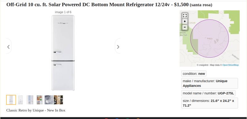

We bought a 10ft3 Unique dc fridge a few years ago to replace our propane one. Very happy with it. The only issue is it doesn’t self defrost as that function is a power sucker. If you put a lot of fresh veggies in it they give off a lot of moisture and the back wall frosts up. They recommend everything in sealed containers to avoid that.
Every few days I pull out the top shelf and use a plastic scraper to remove the frost which I chip into a container and transfer to my beer cooler
Otherwise it works very well and assuming you have solar to recharge you should be ok but I’d do a power audit first
That looks like a nice unit Fish. We are still using an ice chest size 12v fridge, it works great but no freezer and no shelves, which makes it kind of a pain digging everything out to get one thing. And I kill the power for the 1-2 days a week when we are not there, so it gets emptied frequently.

# Posted: 18 Aug 2022 08:51pm
Quoting: FishHog
Quoting: travellerw
Just hard to swallow the price for most people.
Hmm. Yeah not cheap but a few hundred off retail. Should I?
# Posted: 18 Aug 2022 11:36pm
I cant talk myself into it.
What size wiring does one of those require to deliver the 12v?
And how far? I would have to have it close to my charge controller 100' away from the cabin.
A re-worked 120vac chest freezer with some extra side shelving for easy access would be my choice. I can deliver 120vac to the cabin.
# Posted: 18 Aug 2022 11:59pm - Edited by: paulz
Well after some measuring, it's too tall for my space without extensive surgery. They do make shorter units..
My current ice chest size fridge is 12v, on about 25' of 12awg, too thin probably. Draws 4 amps. It's packed with food right now and a pain to get to stuff. Need shelves..
# Posted: 19 Aug 2022 06:26am
Paul..I have less than that into my whole setup including the fridge and generator.
# Posted: 19 Aug 2022 08:02am
My unique draws 5 amps. I’m 5’ from my charge controller so wiring wasn’t a concern for me. You would have to do the math on a long run but you probably don’t want a 12v fridge if you have a long run
Yes they are expensive but for my small solar system and refusal to regularly hear a generator it was the right choice for me. But probably not the right choice for everyone

Just to clarify, I also have 9 Sunworld 260 watt solar panels. Spring to fall use...I looked up that unit NBD posted above. Same specs.
