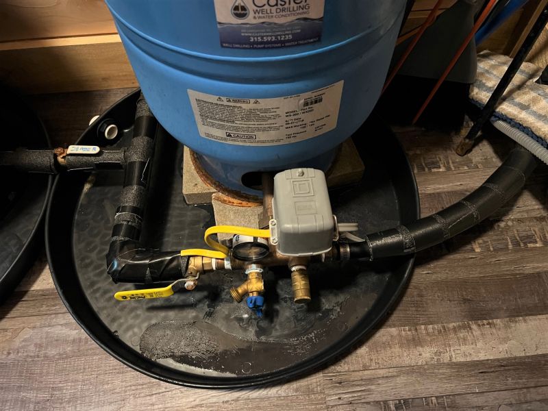

The pump is connected to my generator and only comes on when the generator comes on - historically, I would turn the generator on, the pump kicks in and fills the 2 tanks and they remain filled till they are used up
Now however, exactly the same as above, except the tanks drain back after a little while and clearly the pressure guage drops as a result
Both tanks are sitting around 41psi
This is a picture of my tank set up.............the water is condensation - as the well is so deep, the water is ice cold and it forms condensation on the tanks and pipes due to the extreme temp difference
So based on the comments, looks as though I really need to pull the pump, dig up the trench and have the pump, lines and valves checked

Everything looks good at the pressure tank, assuming the inlet is on the right side.
Pull the cover off the top of the well head. Wait for the pump to shut off, after it reaches the set pressure. Listen for water spraying in the well casing. If no sound, that eliminates that section of piping above the water level.
If you ran 160+ PSI poly pipe from your pump to the pressure tank it is unlikely the actual pipe is leaking. Fitting connections or the check at the pump are more likely the issue.
I would check where the pipe comes into the pump house or structure and where the pipe leaves the well casing as the most likely locations for a leak. Also if there are any tees in the line for outside water. Yard Hydrants can leak underground without showing up on the surface is certain soil conditions. Once you have eliminated everything above the pump you can probably blame the check on the pump.
