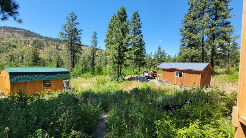

My wife and I just bought a small chunk of land in Central Washington with a small dry cabin for family recreation and hunting... we have a composting toilet and plan to bring our drinking water in, so that is covered for now. The next priority is water for washing up and showers. We are very fortunate to have a small creek with clean water close.
I plan to use a transfer pump (milwaukee cordless) to a water barrel and then run a 12 volt pump to the propane instant water heater for the shower.

Nice place ya got there.
