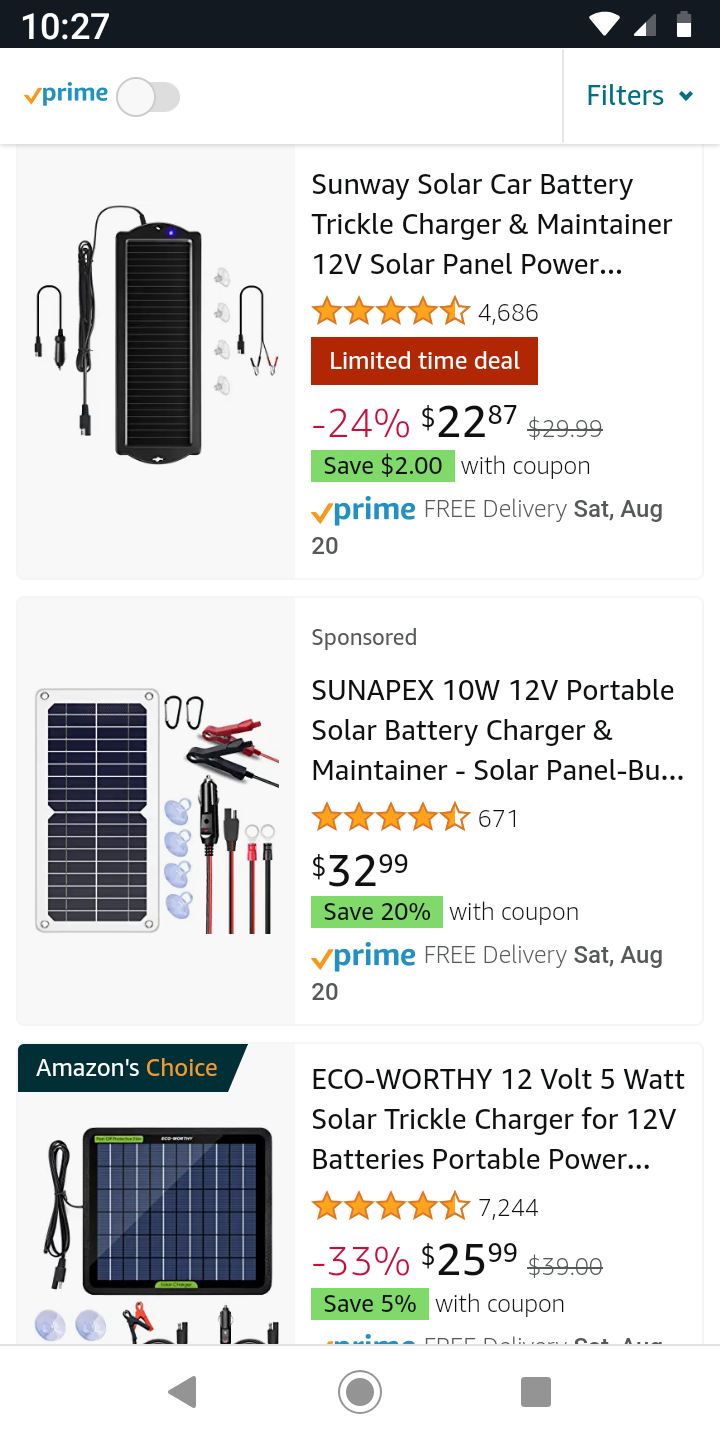

They have solar battery maintainers on Amazon and harbor freight. I use one to keep the battery on my 5 the wheel topped off. They won't charge a dead battery, but still puts enough back in the battery after a little use. Not sure if that's what your looking for, just another option.

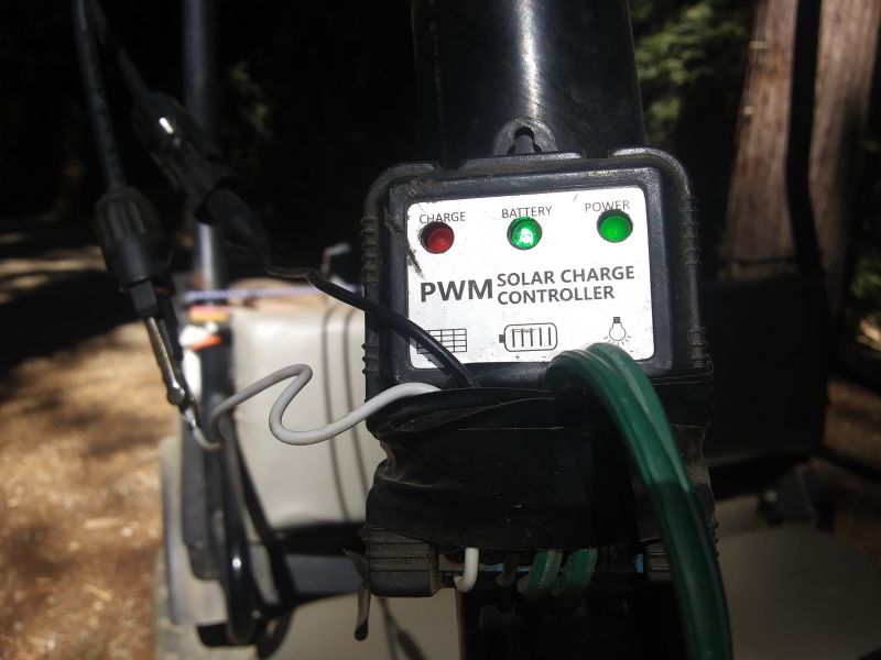

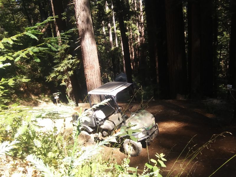

About a month ago when I started building my carport, I put an MP3 player and 2 way radio to the cabin on my UTV. Much nicer working to music. But after several hours they were running the battery down, so I stuck a spare panel on the roof and a $10 PWM controller. Problem solved, plus it keeps the battery topped up when I'm away.

As you folks know, I am a solar guy & live on Solar... So I have big stuff BUT I have a small "Maintainer" which maintains the battery for the little Propane Furnace in my powerhouse which runs off a 12V Sealed Battery. It's actually a 40W Coleman Kit with PWM Controller, nothing special simple & cheap. It's worked great for that purpose for 5 years now.
Their equipment is strictly for 12V, it's all "Plug & Play" simple and they have a variety of kits. Even small Inverters if you need 120V (lights or similar).
They've expanded their products into very convenient packages, they do cost a bit more than if DIY with the commercial products but there's No muss & fuss and good warranty if ever needed. I also have to say their stuff is well built & toughened. (more idiot proof & friendly).
Have a look through their site and check it out. They even have kits just for car storage, and more.

Once upon a time you used to be able to go to a Volkswagen dealership and they would give you a small 12V panel. All Volkswagen's used to ship with a panel (5w) in the window to ensure the battery was maintained during shipping and storage. They had so many that they just gave them away..
I have no idea if the still do that.. but places like Canadian tire, Princess Auto, Tractor Supply, ect all sell 5W maintainers fairly cheap.
