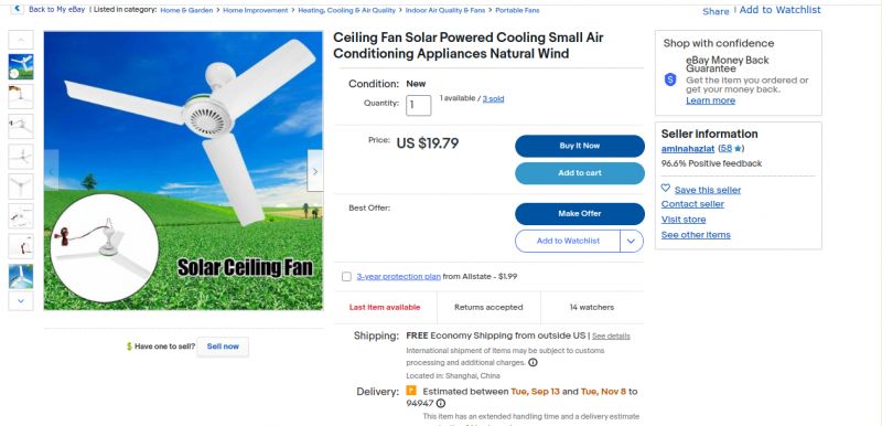

Looks like the ticket for Tim, and maybe me. Interests me for my shop, which on occasion will have morning condensation on the contents, particularly on a sunny morning after a wet or foggy night. It is well ventilated but never any breeze to speak of. I like the idea of having a fan run only when there is solar power available, and no battery to worry about.
I have a 12v ceiling fan kicking around, identical to this 'solar' one pictured. Used it, on battery power, before I went to a 110v fan in the cabin. I just tried it on the solar panel on my UTV and little PWM controller, it works, at least in sunlight. I also tried it on a 6v battery, hums but no spin.
So I know it will operate in sunshine, my question is, when panel output is below what's needed, will the 12v controller stop output so the fan won't hum and burn out?
https://www.ebay.com/itm/203998381073
To answer my own question, with a shaded panel and the little PWM controller (no battery), my fan does the same thing it did with the 6v battery, hum and move a touch back and forth. Can't be good for it, even though it's brushless. Must be something special about the complete kits.
