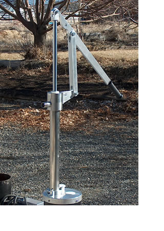

Hopefully this makes at least half sense. I have attached a picture of our pump style for reference if it makes any difference.
Thank you!
Pump
Pump

I've seen motorized versions of pumps that look like the pictured pump. All S/S, right? Simplepump? They have deep well versions but those place the mechanism and valve way down the well hole.
So I wonder what Ryobi means by the 50 ft rating.

If your casing in only 1.25 it is likely just a sand point well and you won’t be putting anything inside of it easily. With a static water level of 12’ an old fashioned pitcher pump will work as long as the level doesn’t drop below 25’. The pump you post a picture of is called a “simple pump” it actually has a rod that drops down into the well at actuates a mechanical pump but it won’t fit in your well. https://simplepump.com/our-pumps/hand-operated/deep-well-pump/
I would try a pitcher pump first they are really inexpensive.
