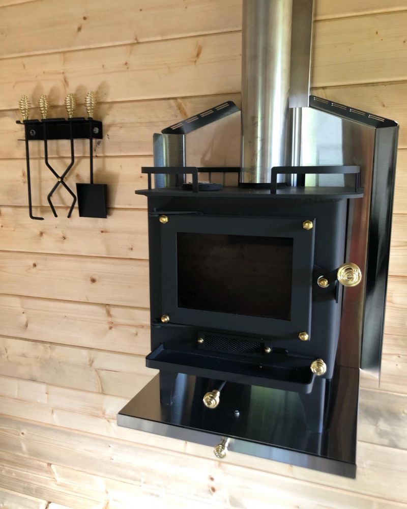

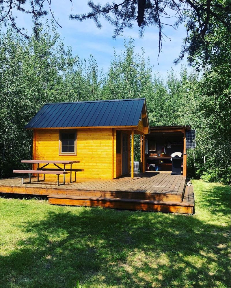

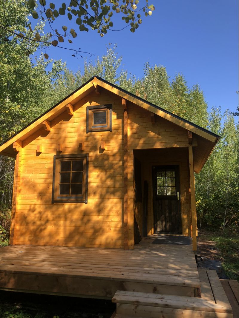

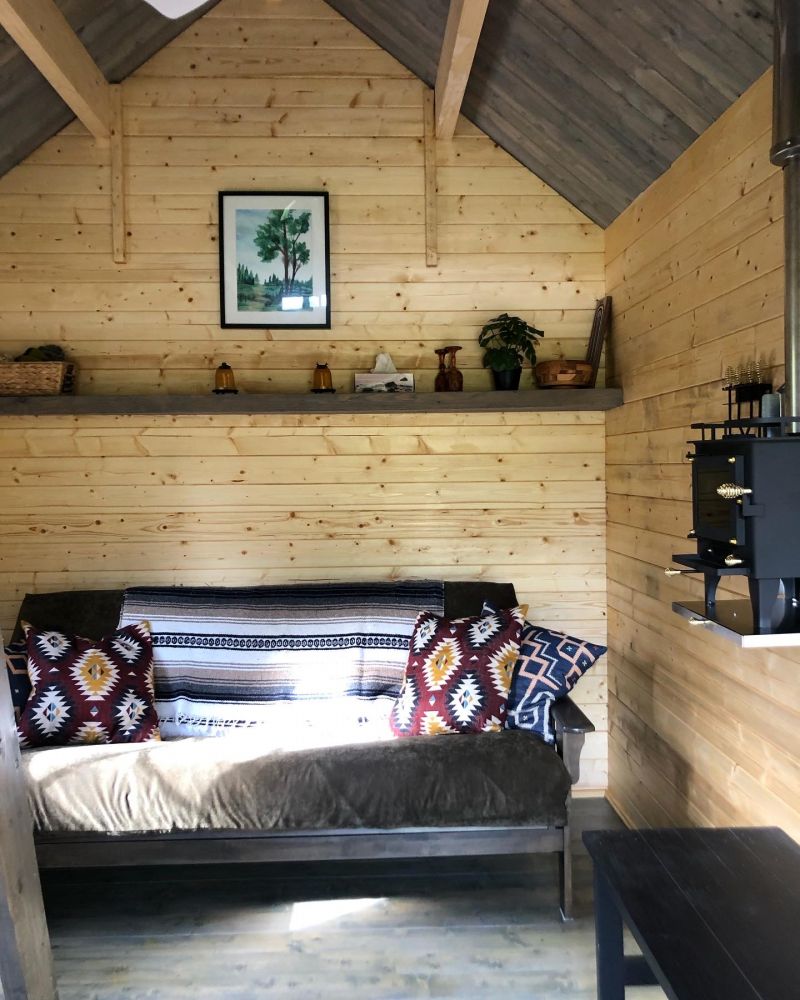

We built 2 of those small Bunkie cabins this year as well 108 sq feet wall half inch thick, double pane windows. The second Cabin is 200 sq feet 2 inch thick walls, triple pane windows. Wood stove for the cabin is all depending on the thickness of the walls, and if you plan to use the cabin year round. We are located Manitoba nice and cold in winter.
The small cabin seasonally and close up at the end of October. so we purchased a cubic mini wood stove. Making sure the chimney goes out the roof so you have more draw with the fire. This is the second tiny store we purchased. I think the cabin heats up pretty decently but to put out the BTUs it won’t be able to in the cold winter. Fire box not Big enough.
The second bigger cabin we’re just in the process of putting in a regular woodstove. it will be a year round cabin.
Small cabin
Small cabin
Cubic min wood stove “Grizzly”
108 sq feet
108 sq feet
200 sq feet cabin
200 sq feet cabin
