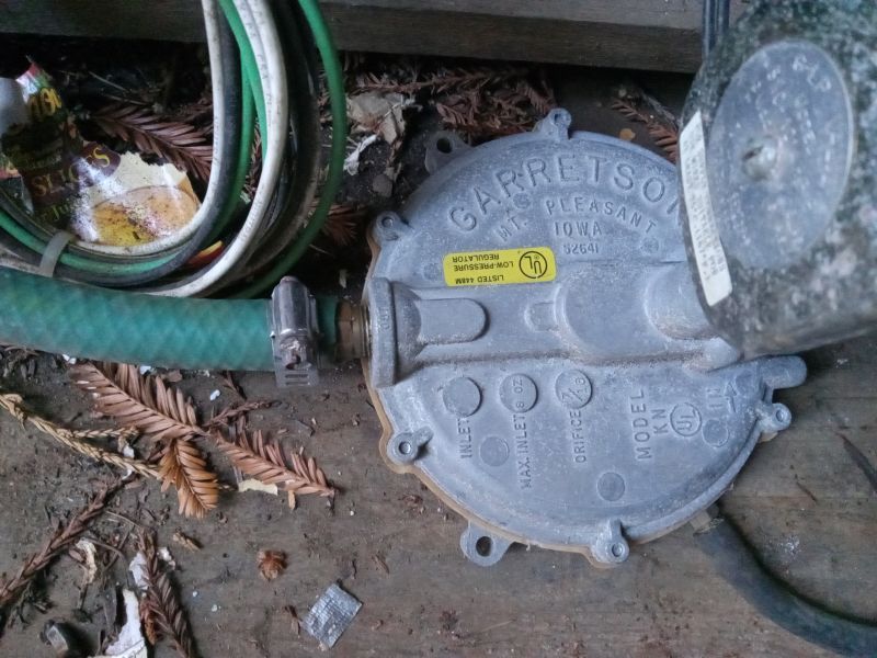

Trying to get my Onan LP genny going. It came with this regulator, Garret model KN. It says the max inlet pressure is 8 oz.. Propane tank, I'm reading is around 150 psi depending on temp.. How much is that in ounces? Trying to figure out if this is the only regulator I need.

there needs to be a high pressure regulator from the propane tank that attaches to the demand reg you have shown in that pic.

As I recall, butane, and/or perhaps butane mixes, are used where temps rarely if ever get below 32*f. This has been discovered by rv'ers who come to Wisconsin from the south in the cold months and their LP equipment doesnt work because their cylinders are butane filled. I dont think there really is any tuning of the appliances to burn either propane or butane, it isnt at all like the diff between propane and natural gas.
The LP conversion stuff Ive looked at to retrofit on my old gen appeared to have a typical bbq grill regulator and a needle valve to tune the intake gas flow. The regulator wasnt even a dual-stage (a dbl bodied one piece unit). I have pulled a couple of those off of junked out big bbq units at the local recycle center. The 1st stage drops the cylinder pressure well down so the 2nd stage (same as a typical sgl unit) doesnt have to work so hard. Its a safety thing. My guess is that one of those would work on your rig?
Ive never had an Onan or an rv with the built-in LP tank so I dont know about if the tank has what amounts to a 1st stage reg on it, thinking maybe so.
