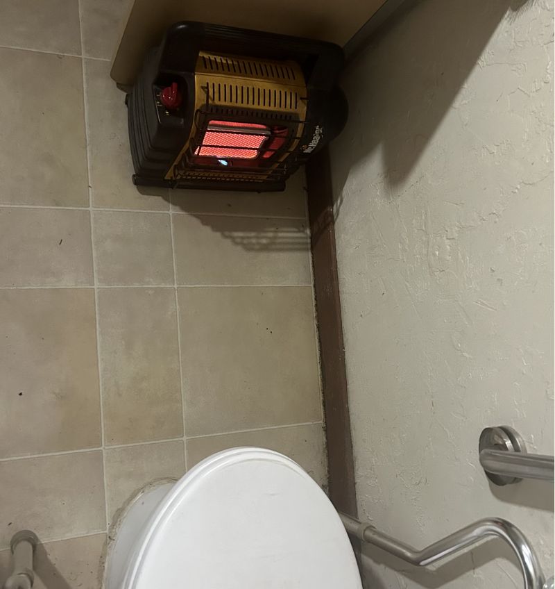

I use a Buddy heater in the cabin bathroom. Maybe that's unsafe in an outhouse?

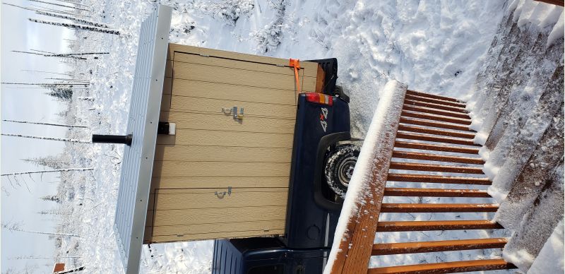

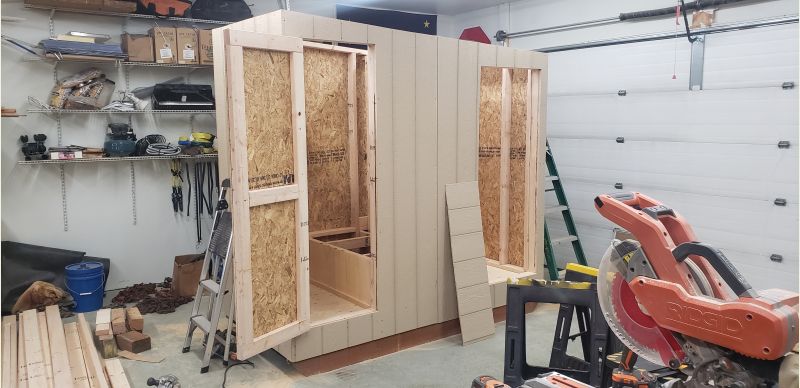

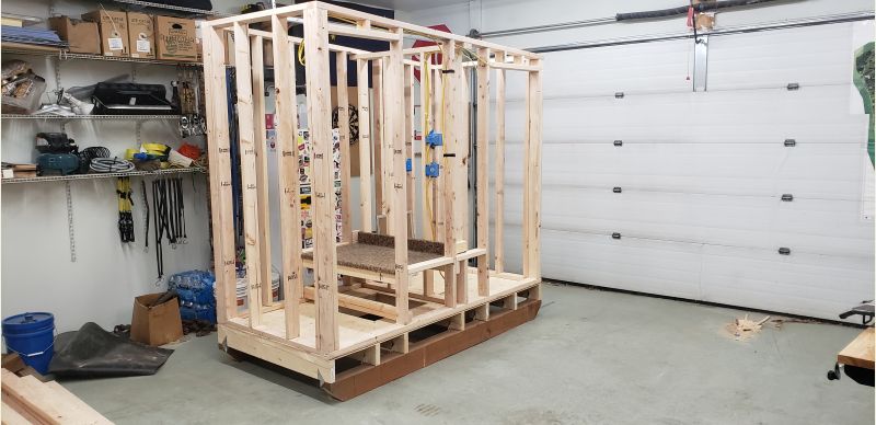

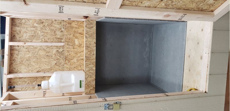

In my cabin community most of us started building our outhouses and generator sheds together. Even the 2000w genny throws off enough warmth to keep even uninsulated buildings slightly warm. Obviously need to route the exhaust out of the building to a safe location.
Built one for a friend. Base was a 4'x8' piece of plywood, split evenly. He has a 3000w genny and it keeps it almost too warm!
BRADISH
# Posted: 27 Oct 2022 12:55pm
Photos for reference.
Built it in my shop, loaded it into the truck with the skid steer, tugged it out and into place with a 4 wheeler.
BRADISH
# Posted: 27 Oct 2022 12:56pm
I also throw in a 150-250w heat lamp bulb above the seat in each one I build. Works like a charm.
But the trick is to angle it so it doesn't point straight down the hole, as not to get an unpleasant view!

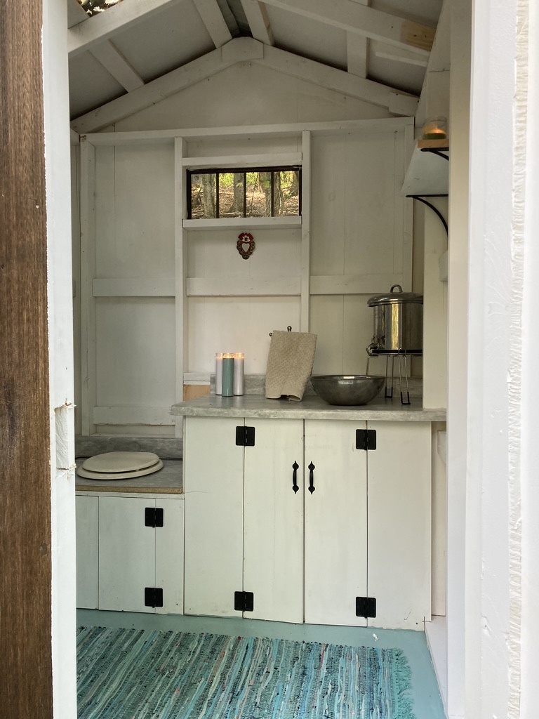

Do candles work to warm it up? Ours is uninsulated and has a skylight and a big window and a small window (visible). It is a humanure toilet, which means the bucket will be removed and capped until it is emptied. I have been thinking about how to make it bearable in the winter. No electric nearby, and atatched to a completely non-electric cabin (within walking distance of a few yards).
uninsulated outhouse

A clay pot base with an inverted clay pot in it. Put 3 spacers under the pot rim for air entry, the drain hole now in the top is the vent.
Get the cheap Dollar Store 'chafing dish' canned heat. Put one lit under the pot and you have a small scale safe heater. Not a lot but maybe just enough?
