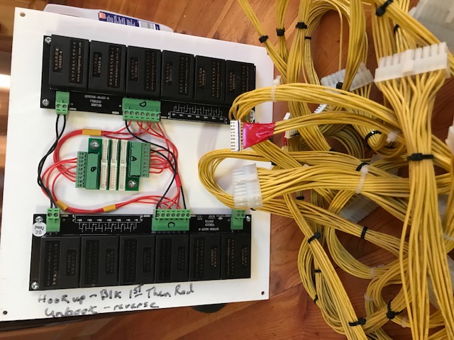

Yeah that was my hangup, just not smart enough, or actually just don't understand enough to know how to wire a BMS in to the existing plug. The harnesses Creeky made could probably be adapted to the BMS, but I wouldn't know how.
This is the balancer and harnesses...
# Posted: 5 Dec 2022 11:48am - Edited by: Nobadays
Here... big end to modules, little end to balancer
# Posted: 5 Dec 2022 02:06pm
That doesn't help me much actually. It's a 12S Balancer setup using two 6s Balancers connected to a 12S Balance Board. The yellow harness' I haven't a clue how that's setup.
# Posted: 5 Dec 2022 03:26pm
Well I was hoping it would klick.... if "rachelsdad" wants to continue using the Chevy Volt modules it would be nice if he could add a BMS. I'm sure he has a similar balancer and harnesses.
