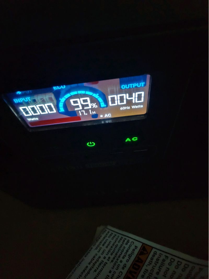

# Posted: 22 Jun 2023 02:32pm
Thank you mojo43, jsahara24, gcrank1, and travellerw for the valuable information you have provided.
I received the Bluetti AC180 Portable Power Station 1800 watt power station today. It arrived with a 63% charge. I updated the firmware via bluetooth and then charged it to full charge on grid house current. The charge only took 6 or 7 minutes.
As a test of the power station before heading up to the cabin, in my garage I have a 2.1 cubic foot mini fridge. It has been unplugged for several days so as to test start up from the Bluetti.
I plugged the mini fridge into the power station and the fridge fired right up. It fluctuated between 37 and 41 watts on the readout for a bit then settled in at 40 watts. The device readout says it should have power for 17.1 hours. This is better than expected! Please see the attached readout pic.
I think for the cabin that a little bigger mini fridge should be ok, maybe a 3.5 cubic foot or better.
Thanks again for your valuable input!!

travellerw
# Posted: 22 Jun 2023 02:41pm
Quoting: jvgo
Remember, that once a fridge is down to temperature it will only run %50 of the time. So your 17.1 hour number will go up quite a bit!
