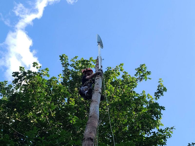

The Starlink dish is very light weight so it does not require much to support it. And it self adjust, so you don't have anything to do once it's up. Harbor Freight makes a collapsible flag pole that a lot of us use to mount the dish, There are adapters for sale that make installing to the top easy.
I have seen a few installs that they used ladder to get as high up a straight tree as possible, cut the top out of tree and use ring clamps to hold flag pole to trunk
Here is one using climbing spikes, lol
