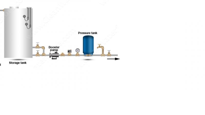

I use what is called a booster pump with a 40 gallon pressure tank with the pump on at 30 psi and off at 50 psi. Sort of like what's in the diagram image I copied...
I keep 700 in the storage tank to be sure there will be water readily available if the sunshine has gone south for a few days. We average no more than 50 to 60 gallons on a normal day; most often less
After that the system is just like what would be found in any house with sinks, toilets, etc fed by a utility system or std well.
tank-booster
tank-booster

The cabin has a much smaller storage tank but the cabin system is quite similar to that drawing of the house system. My cabin (and Bus/RV) have smaller water storage tanks and use Shurflo 4008 series water pumps with NO pressure tank.
The Shurflo RV pumps are designed to not need a pressure tank. In the RV industry they are referred to as an accumulator tank. These are quite small and are meant for use in situations where the RV water pump is short cycling on-off-on with less than 2 seconds off between being on as water is being drawn.
FWIW, the Shurflo in my cabin was installed about 2009. The one in my bus is older. Both have worked fine with only the need to clean the diaphragm chamber once or twice.
The Grundfos submersible pump we use has soft start. There is no high current surge. That places less stress on both the electrical and the plumbing systems.
The booster pump the home uses also has a soft start. Of course, soft starts mean electronic controls but that does not bother me. I like the reduced electrical needs and no sudden psi water pressure surges.
There are now also variable speed constant pressure pumps both for RV use and for residential use. These do not need a large pressure tank in the home. If I needed a new pump for any of my three uses I would look into these newer pumps.
You may find some well-drillers are too set in their ways to latch onto some of the newer tech. There is one guy around where I am who is like that. It doesn't pay to be set in one's ways, IMO. There are more ways to skin a cat than there used to be.
I love the solar-powered Grundfos. I bought it as a pre-configured system. It was a local-ish company but it closed a few years ago. All the parts are known brands with replacement parts available though, so that is not a problem at all as warranties have run out anyhow.

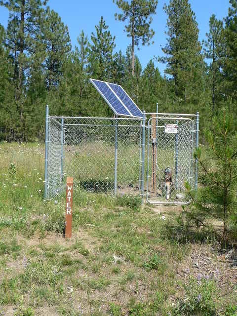

# Posted: 2 Feb 2023 08:27am
Quoting: NovaDC
That's great - just what I'm looking for. How deep is your well? Is it a 12v or 24v pump?
Its 178 feet deep, the static water level is 100 feet, the pump is down about 50 feet under water. I can fill a 7 gallon jug in about 5 minutes, maybe less.
My pump will run on anything between 12 to 36 volts and even a little more. My 2 panels are about 170 watts, on a mast, rotate to follow sun as needed.
# Posted: 2 Feb 2023 08:31am
Quoting: NovaDC
So, something I will probably figure out, but how does the pump shut off when the tank is full? Do you mean you leave the pump on and if there is sun and space in the tank, it will pump water?
Solar livestock well set up uses a float switch, so when tank is full, it shuts off. I do not use a float switch as I am not filling any tanks. I just full my jugs as needed. We do fill a large 55 gallon drum, just let ti fill, then transfer it to the holding tank above the shower where its painted black to prevent algae and also absorb heat, but also have a propane water heater if its too cold.
duckduckgo the words "livestock wells", this is what you need.
