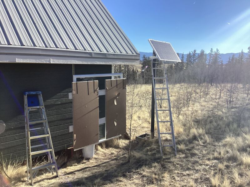

I am thinking of increasing my solar panels from 1-100 watt panel to 4-100 watt panels. The conundrum is the solar panel frame and location.
My thought is to arrange the panel so it lays flat on the south side of the cabin while I am gone. When I come out, move it the where it can more fully capture the sun’s rays.

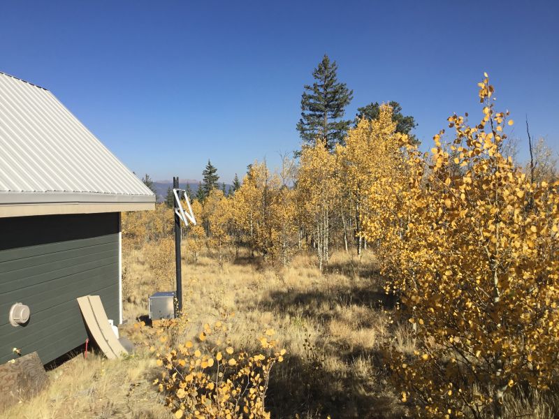

The photo I am enclosing is from Sept 20th 2019 @ 4:30pm.
It was just before I mounted my 1 panel on the pole.
My thought is that even when I am not there it will keep the batteries topped off. During the winter, the panels will be out of the way of snow that slides off the roof.
My first thought was to build a frame where they are mounted vertically instead of horizontal.
Any thoughts, suggestions, ideas, pros/cons.

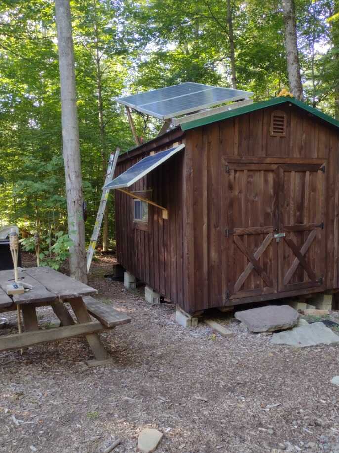

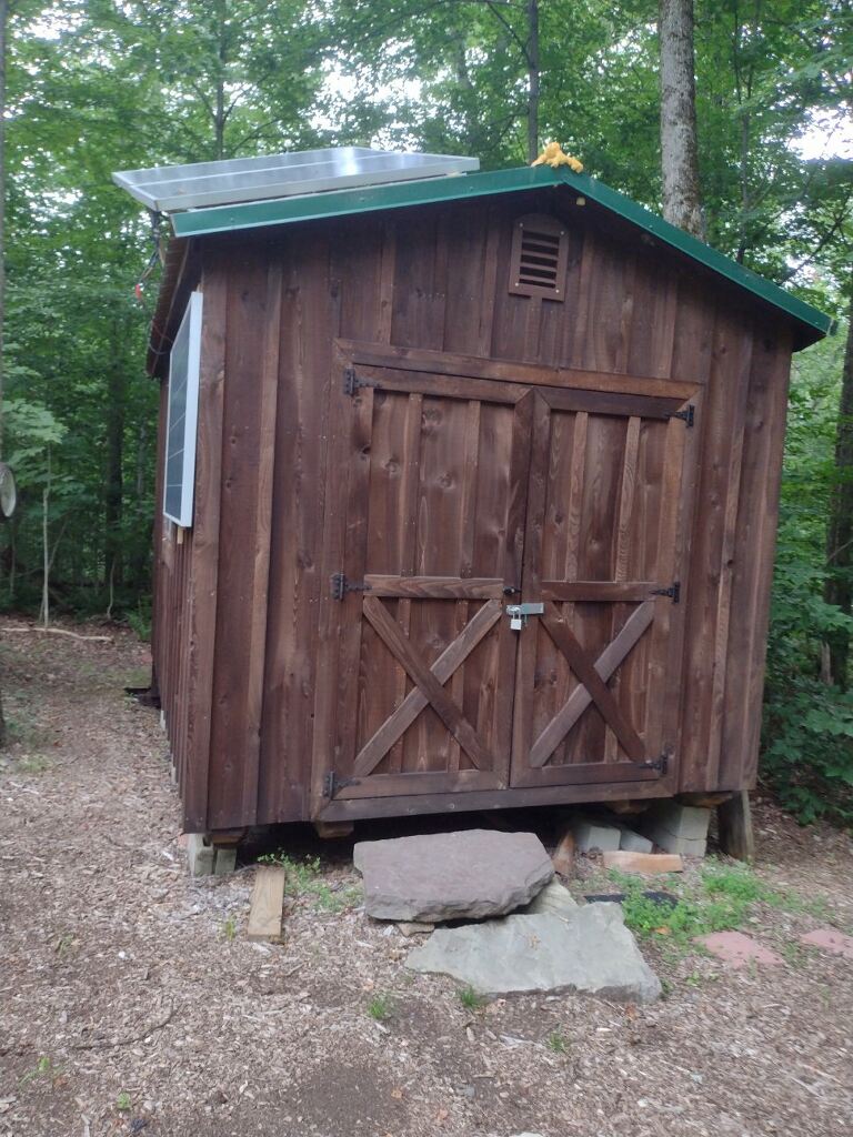

I have a 230w pannel on a hinge with a kick stand just like your wanting to do. My only regret is not doing this sooner. Adds capacity and always works in the winter.
You can kind of see my tree cover, I'm highly shaded and out of the 3 pannels I only get about 3hrs of sun on them.

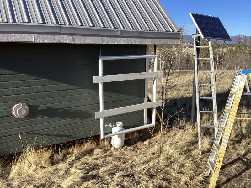

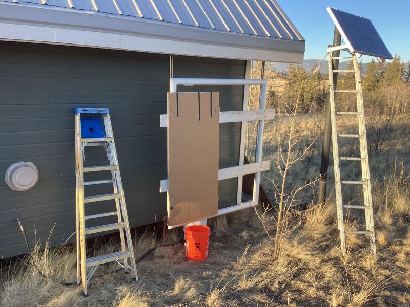

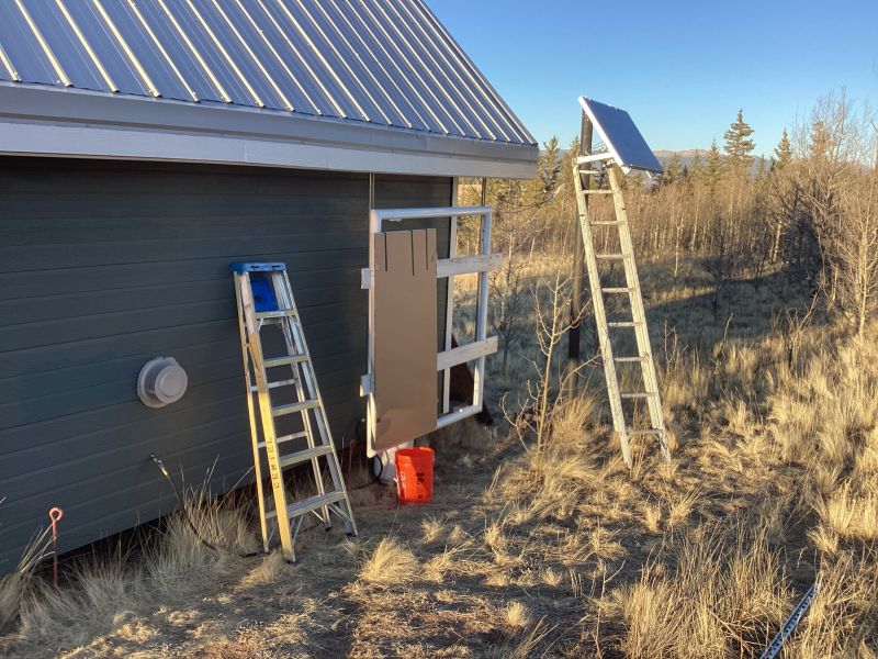

Update. I constructed a frame. Hung it just back from the eave. Hung the panels on it. In the coming summer months, I can swing the bottom out the catch sun with a better angle. Tye it off while I am not there.
And yes! I plane on cutting the Aspen down.
# Posted: 12 Apr 2023 08:49pm
Looks like a workable plan
