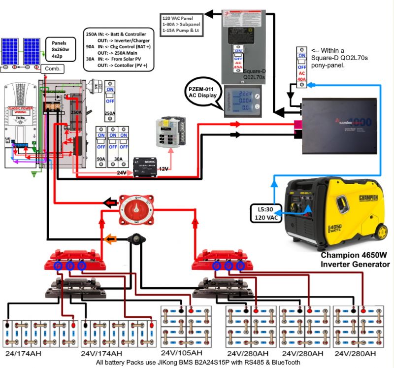

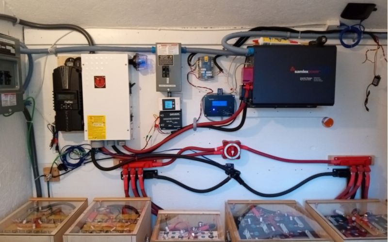

# Posted: 2 May 2023 10:19 - Edited by: Steve_S
Attached is my Version 5 of my build... An actual Photo & the Logical Diagram.
This is going to change yet again this spring as another Midnite Solar Classic-150 with 2370W Array gets paralleled in for an additional 94A Charge Input.
Extended details, parts used etc can all be found here: https://diysolarforum.com/threads/my-diy-off-grid-cabin-setup-in-ontario-canada-24vdc -120vac.1484/ V5 Actual system Photo
|  V5 Logical Diagram

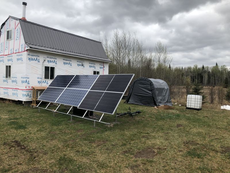

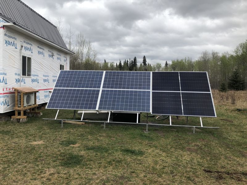

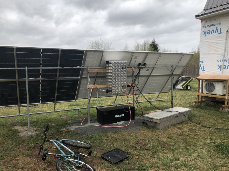

# Posted: 7 May 2023 18:40
Well.. I finally got out and finished the panels and controllers. I still need to trench some conduit for all the wiring, but I had a 30A RV extension cord I bought at auction that is now my temp install.
So far its working better than I thought. On Saturday we ran the heat pump in AC mode completely off the solar (+28C here). Then this morning we ran it again in heat mode (+14 here, sigh, Alberta). My wife was also making breakfast with the toaster and I happened to look at the Victron BMV. We pulled 3.2Kw out of the Growatt/Batts for like 5 min. Technically over the 3Kw rating but it handled it.
Even with those nasty overcast skies I was still able to put about 200W into the batts after the womping we gave them!
(P.S. One thing I don't like about the Growatt is the switching speed (inverter to generator). Its not fast enough and quite a few of our items reset, including the AC). IMG_1843.jpeg
