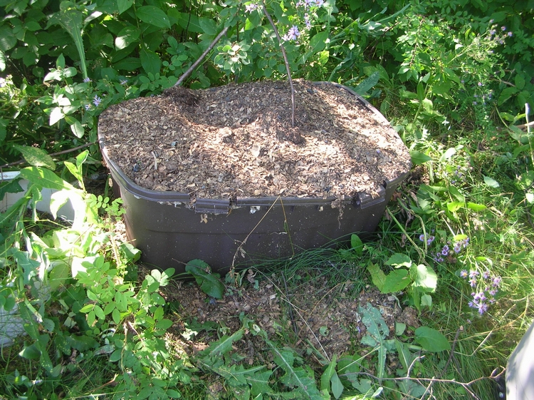

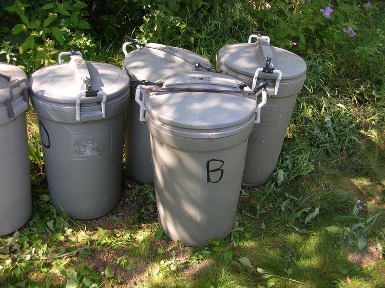

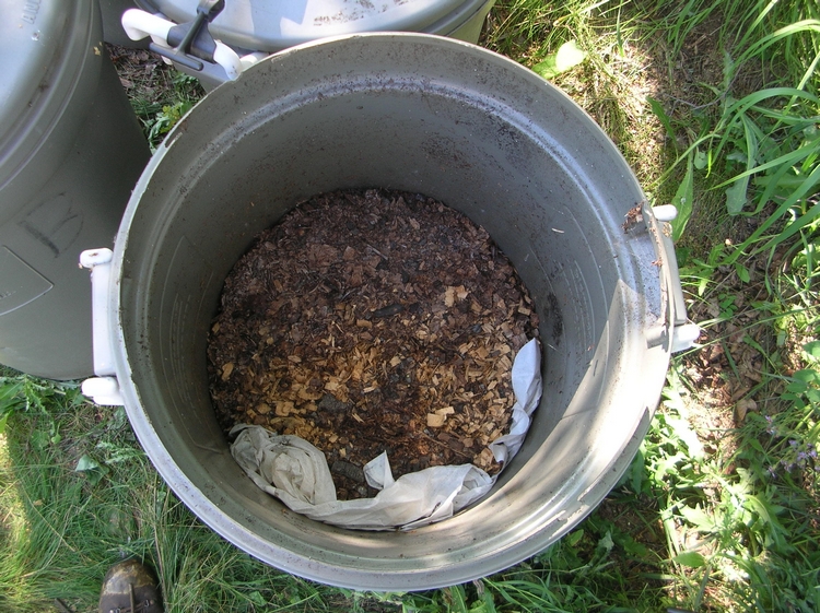

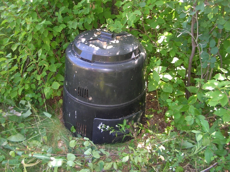

# Posted: 11 May 2023 06:45pm
The temps where we are in SK range from -40c to +40c... We have 4 plastic garbage bins which we rotate thru in about 2 years. This provides the initial breakdown. The contents of the bin, after 2 +/- years, is then dumped into a basic garden composter for another year or so. The results are quite spectacular... The contents from the composter is used to "seed" the garbage bins...
bins- primary composting
inside a bin
inside a bin
secondary composter
secondary composter
final result
final result
