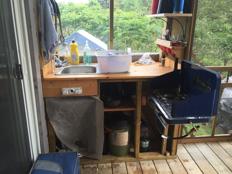

Although I have a larger sink inside (not plumbed yet) we use out outside kitchen (under the covered porch) for all cooking and dishes. Very small space so went with an ikea sink that has a side extension for placing a dish rack etc. Not expensive and is large enough for lots of dishes. Ikea Sink

I use the same sink that Razmichael shows. I also got the cutting-board / cover for it that fits on it... I believe they still have 3 models of this @ Ikea (they did) with a shallow one, a deeper one and a larger one (width) but I don't know if they still do.
