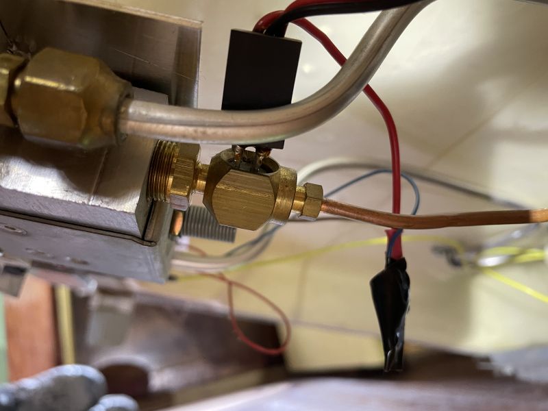

# Posted: 14 Jun 2023 01:11pm
It is a very simple fix. Just unscrew the small part at the regulator that the wires from the detector go into (mosfet). And then reattach without it. Should take 2 minutes. I have done this to my Unique works perfect. The only thing you will lose is the indicator needle will no longer work. If you desire it to work you can order the part from unique and reinstall it in place of the MOSFET.
Clipper
# Posted: 14 Jun 2023 05:17pm
This is the piece that should be removed and then just reattach the inlet to the main.

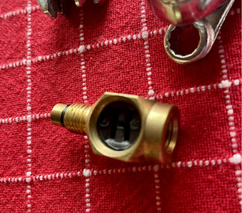

Clipper
# Posted: 14 Jun 2023 05:21pm
The offending part.
browncoatgirl
# Posted: 16 Jun 2023 03:12pm
Omg @clipper, you just saved me so much trouble! I thought that the thermocouple and the co2 detector were connected together on the valve ( as in could not be connected separatly). I just took off that piece and i now have a working refrigerator with a big freezer and i will be eating ice cream this summer 😍😍😍

CheekieBandito
# Posted: 7 Aug 2023 01:29pm
I can confirm removing this part will allow the fridge to operate.
Got to my place on the weekend to hear the CO detector beeping. First thought it was just the battery as I had it die on me last year. Replaced it but it was still beeping. After reading the back of the unit I realized the detector was at end of life. Wonderful…. My place is water access and in the middle of a 25 km long lake. Next day I head into town only to find out that the CoStar detector isn’t made anymore and no one seems to make them with a shut off except that RIDICULOUSLY priced unit from Unique! Ughh… luckily with some googling I found this site and thread regarding the issue. Removed the part this morning and the fridge is running again! So I’ll just add a battery operated CO detector were the old unit was… no more worrying about the fridge not working.
