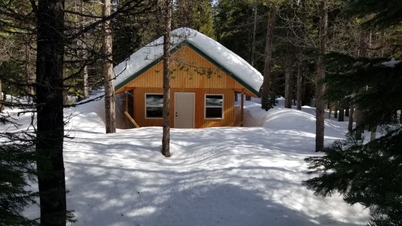

Quoting: Link44 ICC, What water heater are you using? I'm sorta old school.... use a Suburban RV water heater. 6 gallon tank. It is a direct ignition type. The ignition system runs off 12 VDC. No pilot light. When the water temperature drops it will fire up and run and shut off when hot.
I have it installed in the cabinet base under the sink and counter. I added 2 inches of foam insulation around all the tank sides on top of the foam insulation sleeve it comes with. The on-off control switch is mounted on the wall near the sink. The burner does not run much and the extra insulation holds heat pretty good. I'm sure it does use more propane than an on demand but I like it.
It is similar to the one I have used in my bus-rv for over 25 years. (not the same tank all that time. ) Except the bus also has a 120 VAC heater element that can be used on shore power instead of propane.
It does require a hole cut thru the cabin wall. I use the RV trim ring and access panel. I like it over any of the cheaper on demand heaters I looked at. Works well with a mixer valve shower to regulate water temperature just like at home.
That is a good amount of snow. This past winter we had even more build up at times.
